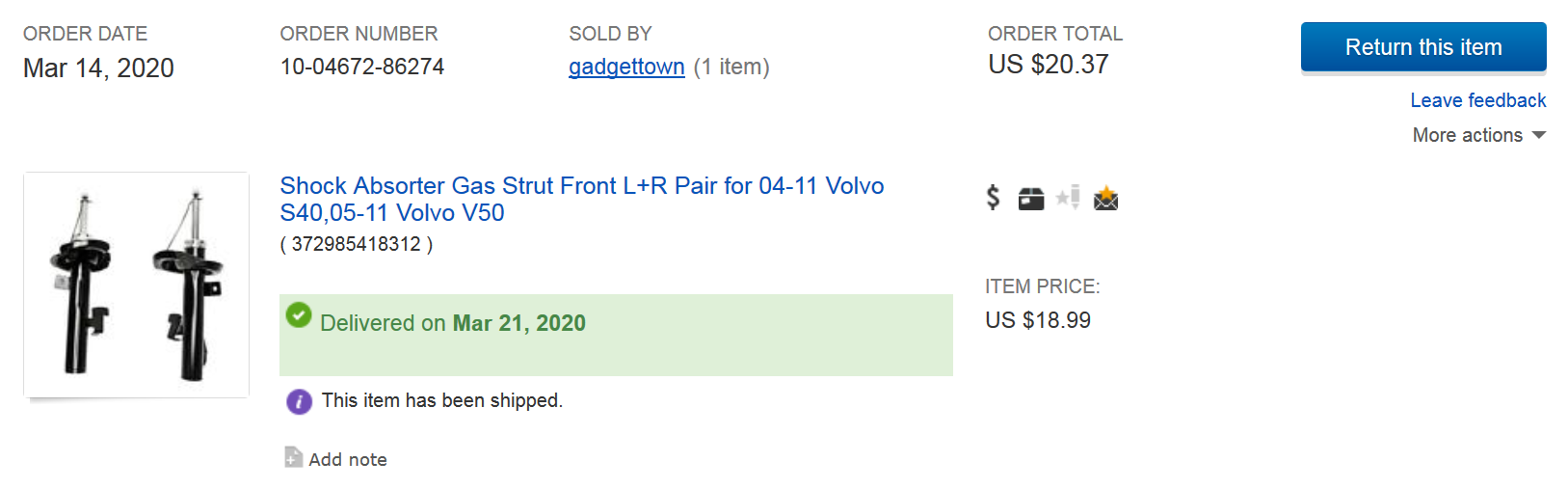

Ok, I just order a set of these at $18.99 with a $2.99 2YR Square Trade Warranty totally $23.36 delivered from this seller. He has raised the price back to where everyone else is selling this strut.
https://www.ebay.com/itm/Shock-Absor...72.m2749.l2649

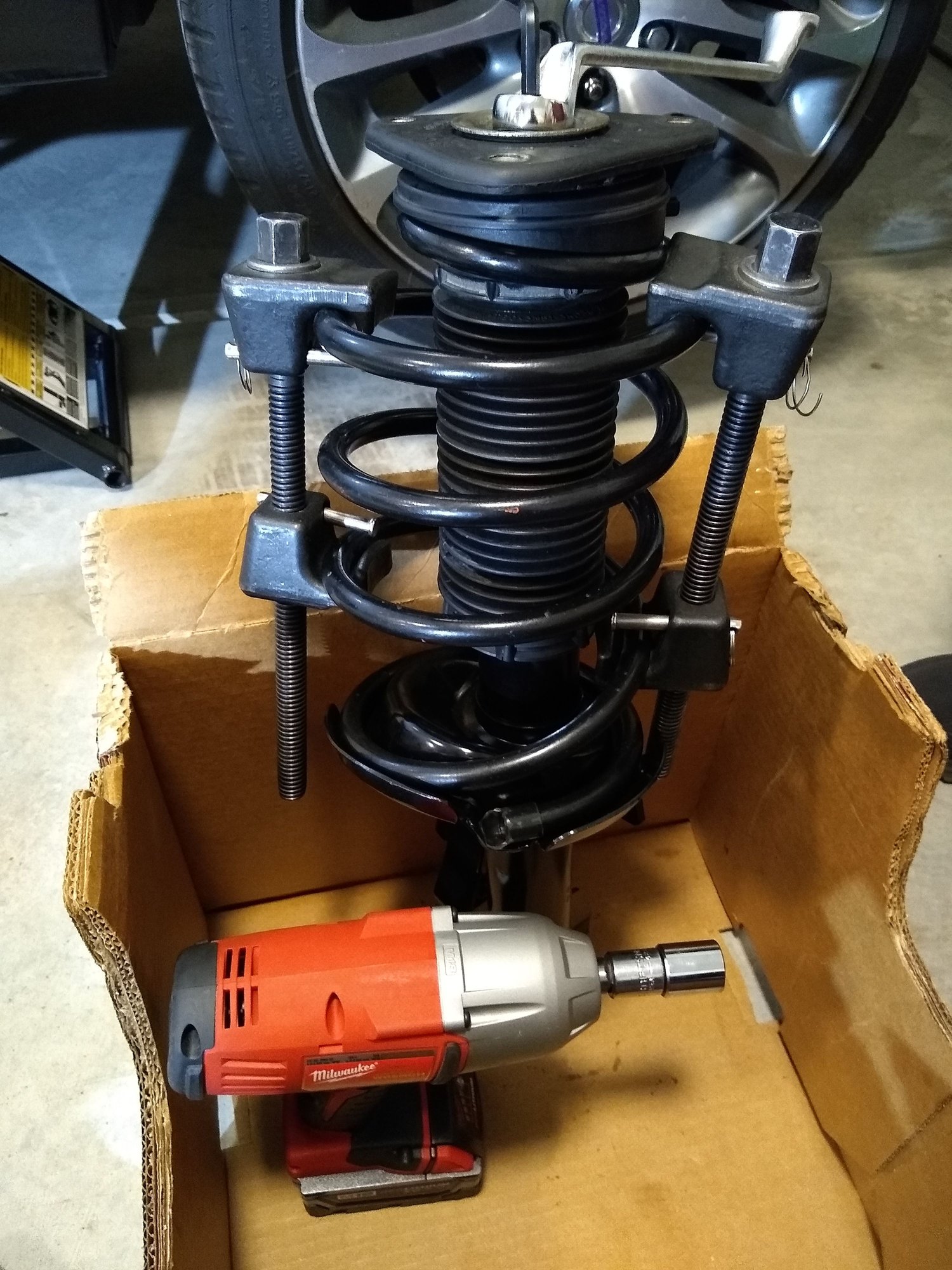

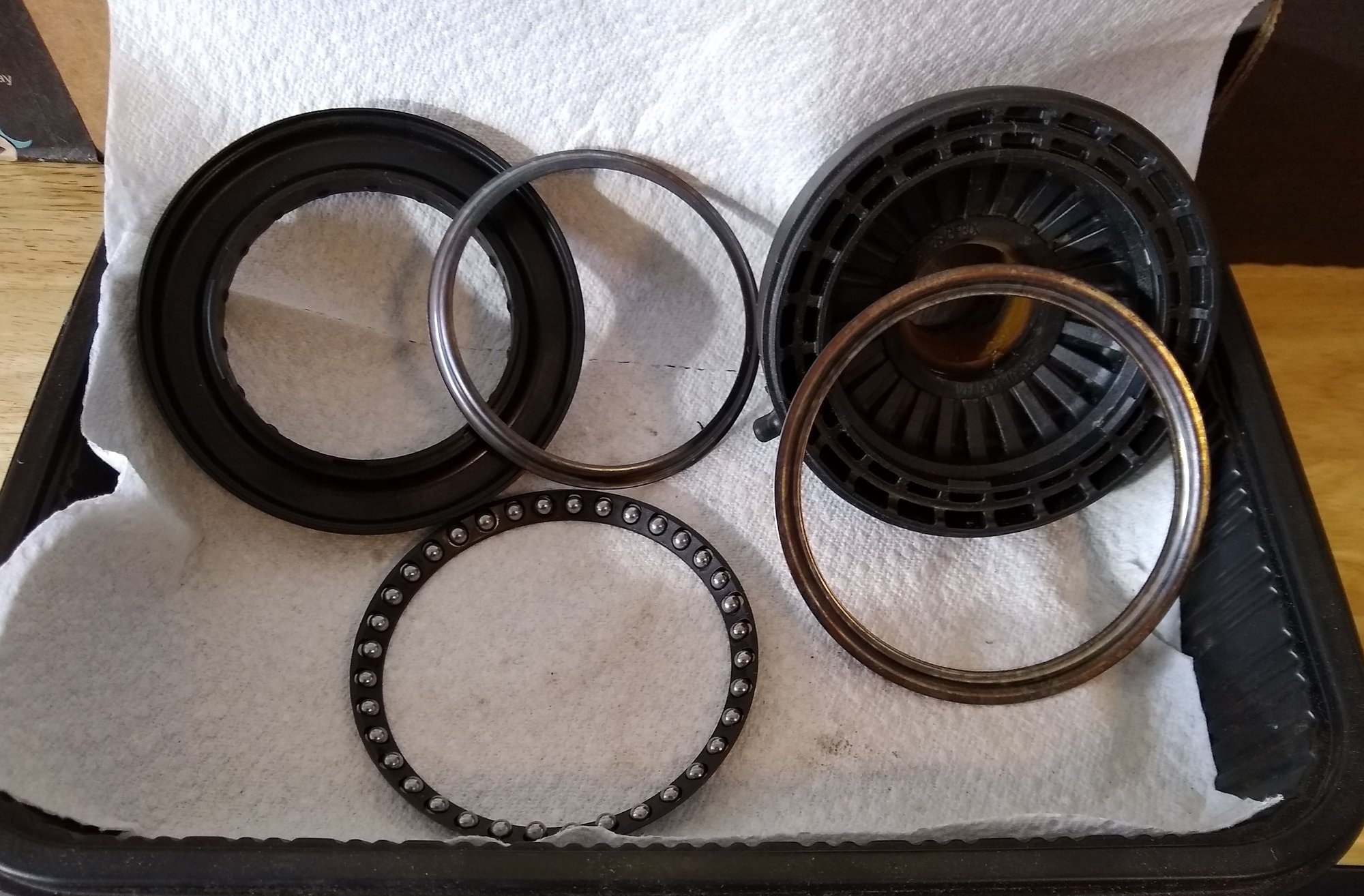

Found a cheap set of Struts on eBay which normally goes for around $65 dollar. Installed the passenger side first as it was already leaking when we purchased it 1.5 years ago. On your input I didn't order a set of Strut Mount and Bearings. The original Ford units were still turning well with a little grit inside. Took it apart and cleaned it and repack with Brake and Caliper Grease. Smooth and quiet on the road. Will install the driver's side today.
Loan a premium spring compressor from Advance which had a $299 deposit. Did not work well and wasted a lot of time so will go back to borrow the $60 deposit unit today.

Installed the driver's side using the $60 deposit loaner tool and it worked much better. Don't have to anticipate bottoming out on bumpy roads any more. Should have done it much sooner. Can enjoy the drive now instead of watching the road as if you are preparing for that steep dive on the roller coaster ride with the pit in your stomach waiting for that big thump in the suspension.

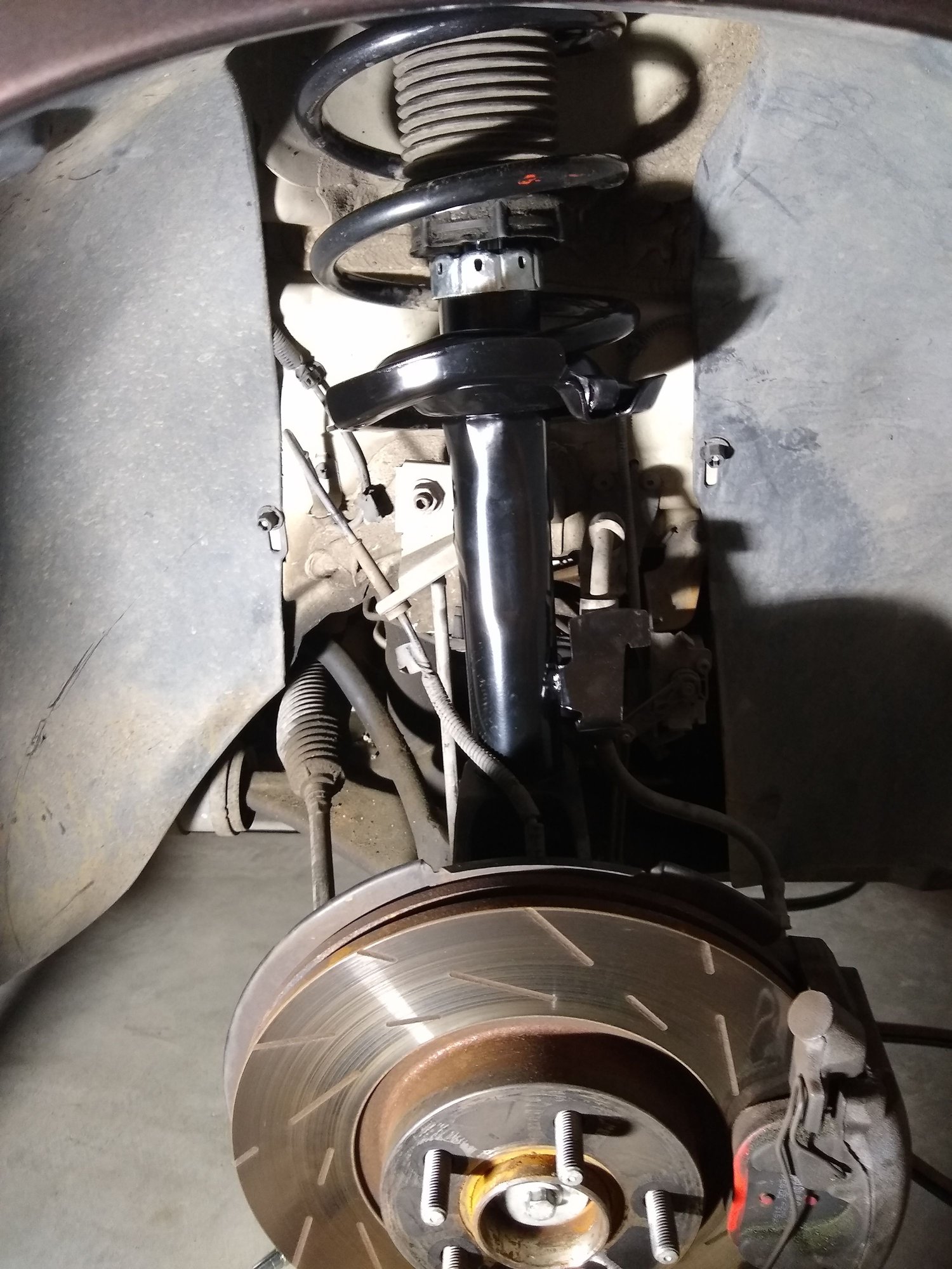

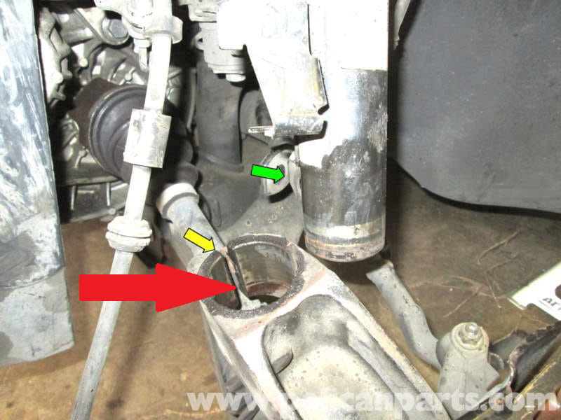

It took way, way too long. Here is where you will spend your time and if you get this right you'll be a very happy camper. I don't like to use force, meaning striking the knuckle with a hammer. Lube everything not to get it on the caliper and pads. Cover it with a towel as our strut was leaking for a long time so it was full of dirt and grime while on the other side the broken CV boot grease everything.

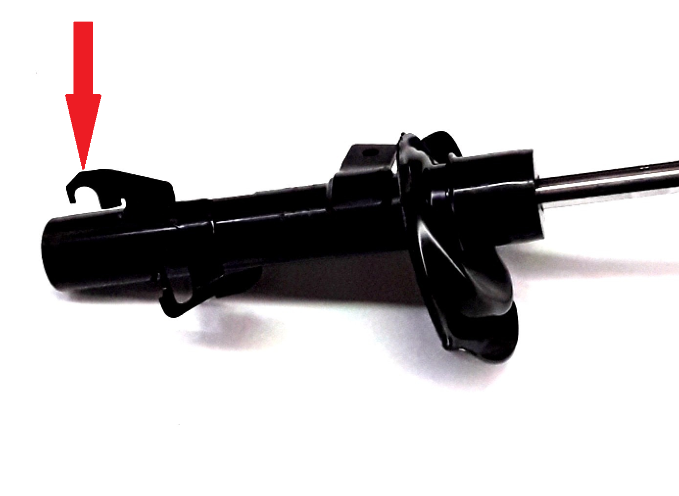

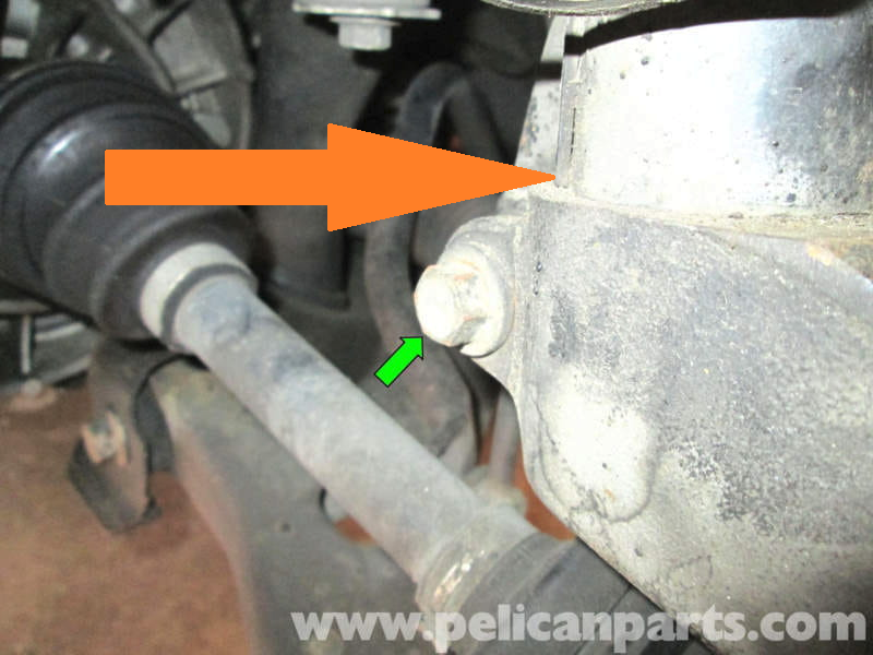

The video show the guy making a tool to spread the bottom of the steering knuckle so the strut will slip out. That is a must! Even if you can hammer it out you still need to put it back in. Go over Pelican's link also but you don't need to remove the bottom nut of Sway Bar link, it is not necessary.
https://www.pelicanparts.com/techart...eplacement.htm
The hook is where the nut passes through the knuckle. The remainder of the strut is farther down. There is room from the back at the lower portion of the knuckle to insert a tool as in the Video to spread the knuckle and the hook won't be in the way. The Green Arrow in the second photo is pointing to the Red Arrow in the first photo.
Best to insert a tool to spread the knuckle.

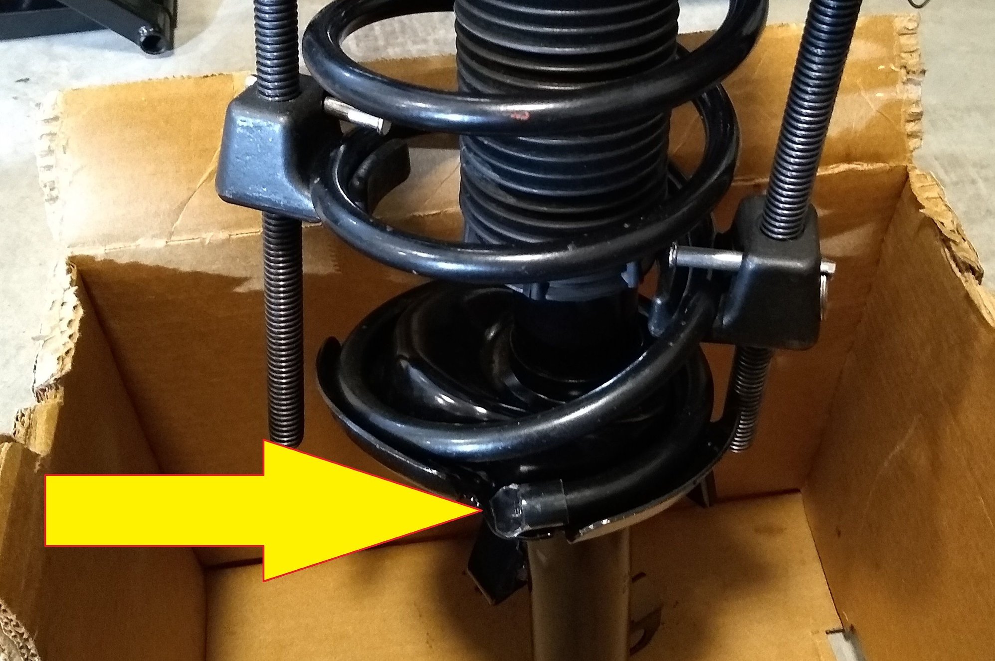

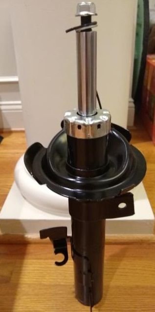

I inserted a clear tube (or hose) with a cut out / flap folded at the end in case the spring ever bumps the strut perch end and cause noise. The flap is also side ways so water drains and is not trapped. I suppose that would be a problem only in areas where there are harsh winters.

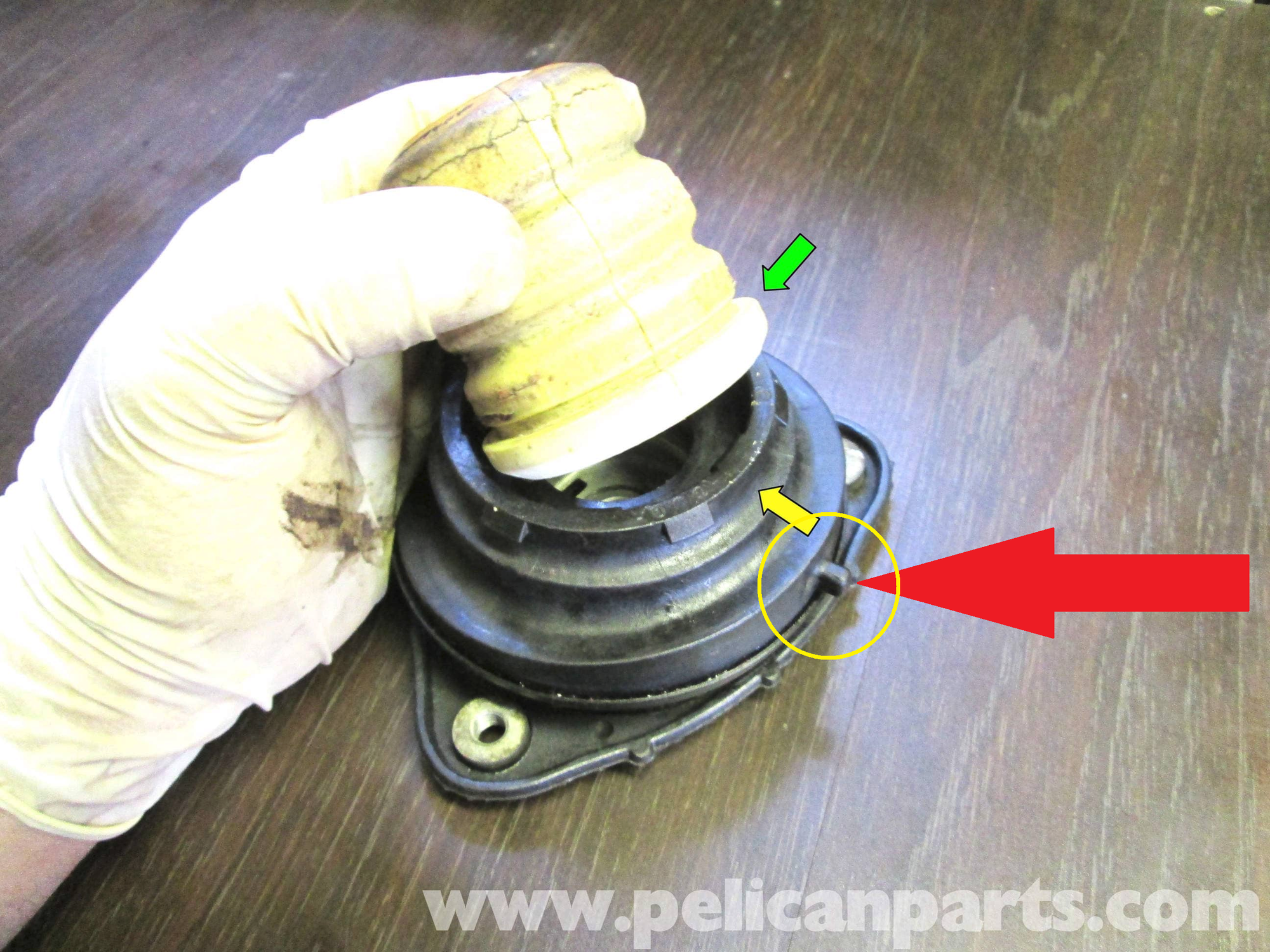

When you remove the strut mount double check to see where the spring rest on the bearing as it is wedged / angle shaped. Our car drives fine but let us know if we installed it correctly as we assume the top of the spring had an obvious place like the perch on the strut for the bottom of the spring to rest. We used the protrusion to match the top of the spring's end.
Lastly, be sure the strut bottoms out into the knuckle at the welded piece on the strut.
