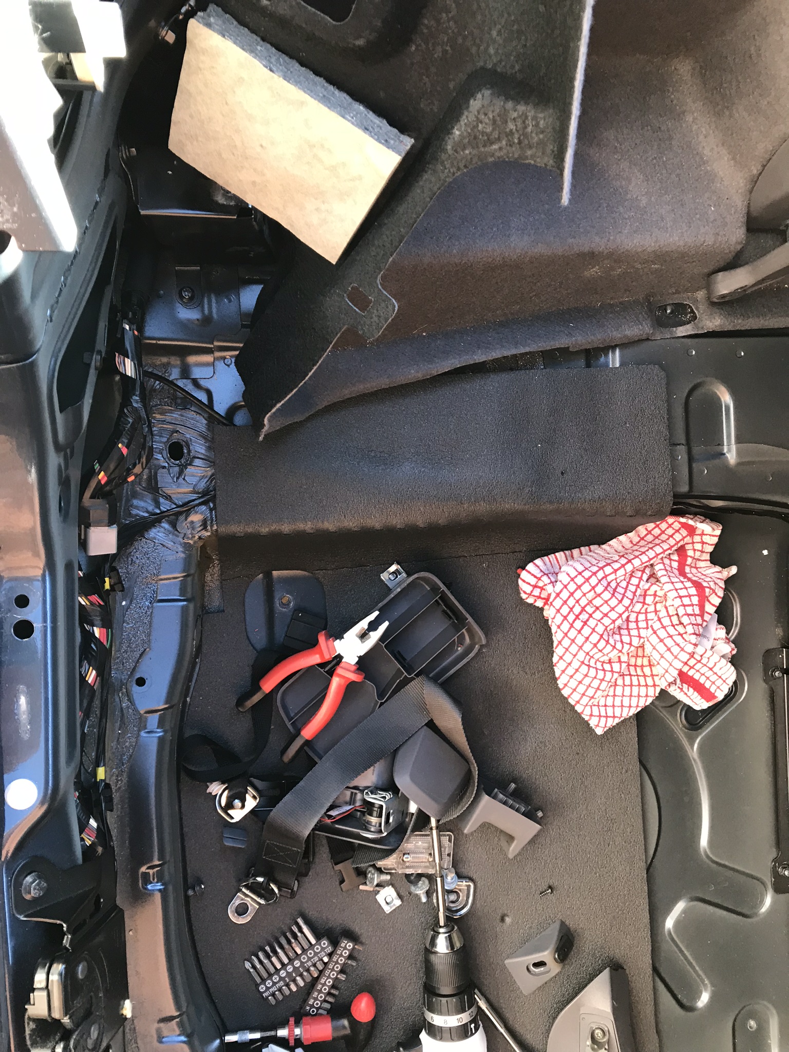

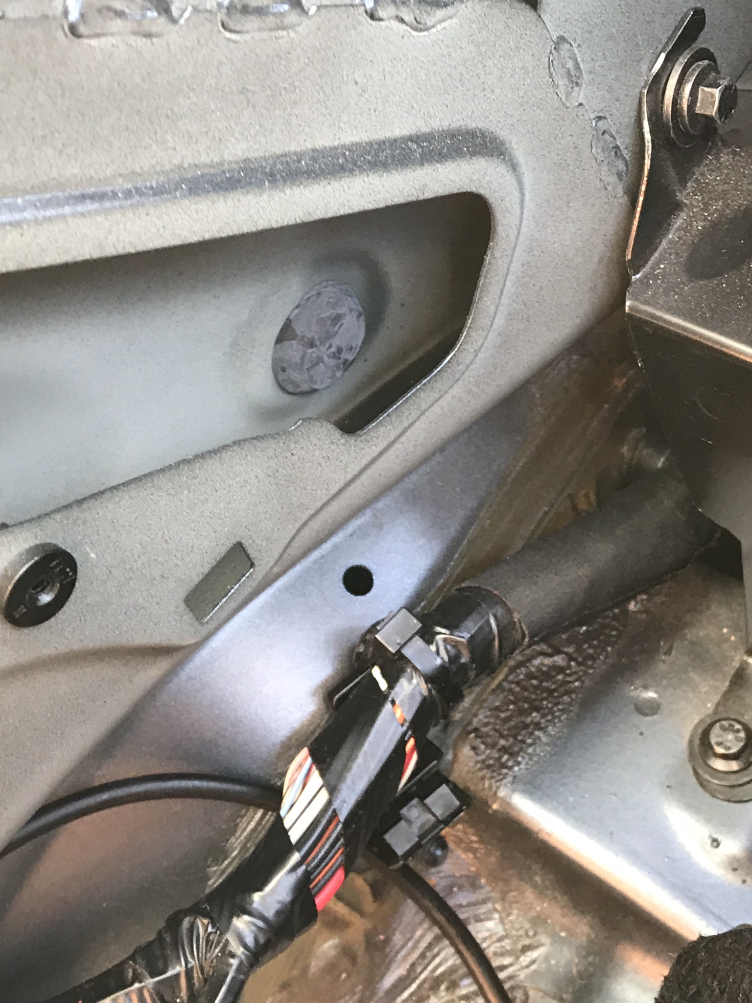

I solved the leak in my C70 quite easily, all I did was remove the trim in the boot,and then poured water at the top around the back areas, in all the water channels and watched the flow. I did the left side first and started at the rear sections and moved up back towards the roof. The water was running around the channels and out of the drain hole, and also along to the rear light cluster.
After pouring quite some water I could clearly see where the water ingress was happening. For me it was at the back near the left rear light clusters, there was a little hole That some cables attach to, which had come lose over the years, and it seemed water was coming in from behind this hole, running down the side (under the trim) and pooling in the footwell.
So I filled this hole with some bathroom tile sealant and so the mystery boot leak was solved!

I solved it, I removed all the trim in the boot, then Cleaned out the water drain holes in the body sides, and poured water down the sides so it ran down past the Drain holes towards the back of the car.
i found that the water seemed to go down behind the light, then behind the metal and at the back of the metal, na dot came into the boot of the car via some little holes that the wiring is clipped into to.
my leak as in my post was on the left rear side but I suspect the other side is the same. I just used some bathroom sealant to fill those holes and then plugged the wire clips back in.
the part I am talking about is the very back part of the vehicle, the inside at the bottom of the boot, not the tyre well but just before that, under all the carpet and trim there are a bunch of cables secured to the body with plastic clips. The holes these clips are in leak water.
