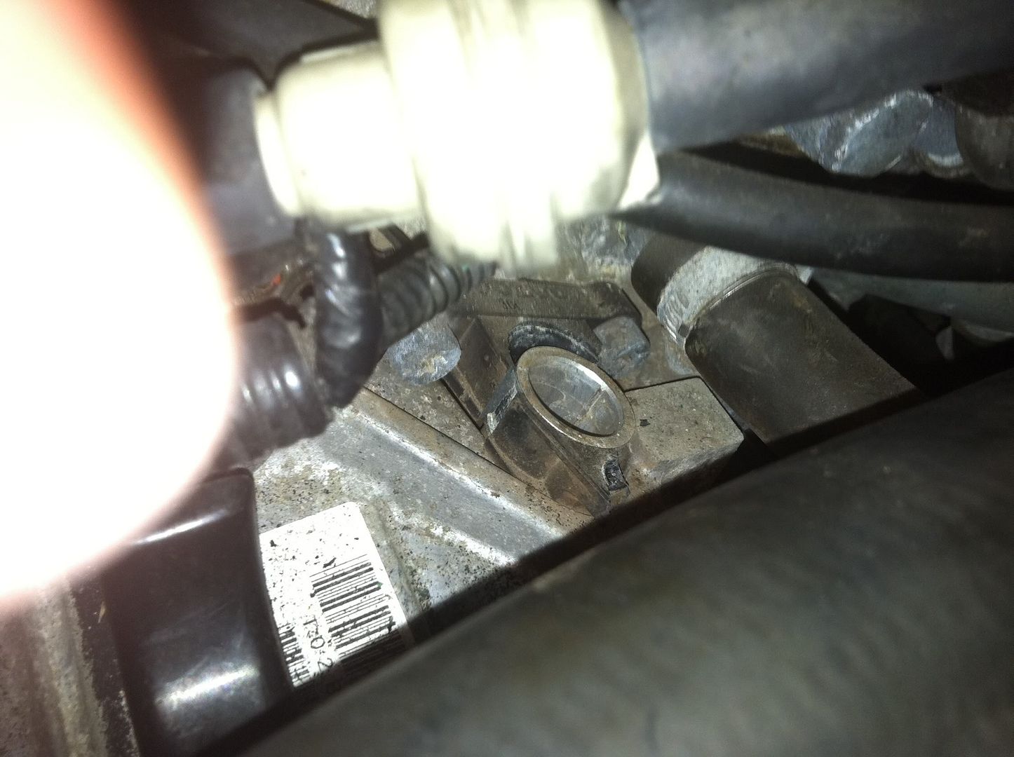

I have an '02 C70 Coupe that I am working on. It needed a new Crank Position Sensor. As I am loosening the nut to remove the sensor, the plastic mount underneath just crumbles and the bolt appears to have sheared off. That leaves a metal sleeve with alot of wiggle room and nothing to secure the sensor to.
Am I completely hosed? Any thoughts?
What's the easiest solution?
Here's a picture:
http://i232.photobucket.com/albums/e...s/IMG_0069.jpg

You're going to have to get another sensor holder; the whole plastic thingy, or try some super glue temporarily.

You're going to have to get another sensor holder, or try super glue temporarily.
I think the screw that sheared is held by the plastic.

I went with superglue because that bracket looks like a pain to replace. It started up fine when it was put back together. The problem right now is that the car stalls twice then runs fine afterwards. I scanned for codes but no codes are set. Could the stalling be related to the cps or should I just wait for another code before I bother moving forward?
