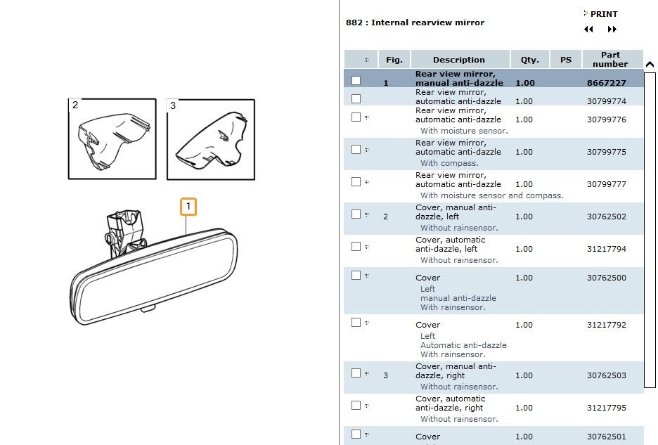

I want to install a backup camera system with monitor in the rearview mirror, which means replacing the oem rearview mirror. I seem to remember seeing something about the antenna for the key fob being located in the mirror and can't find any info to verify if this is true. Help!

That is true for many Volvos - the 01-07 svxc60/70/80 have the UEM in the mirror. The cheapest mirror (30772248) for your car is about $50 - so there is no module in yours. How many wires are attached? Do you have automatic dimming?

My mirror is auto-dimming as is the mirror I plan to replace it with. My car is a 2009 c70
