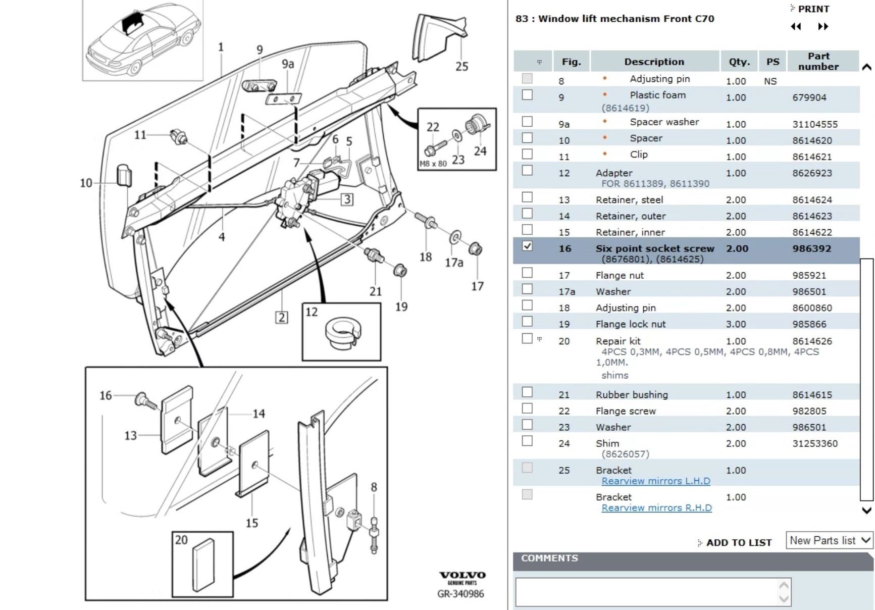

The window regulators are a structural part of the door - very expensive and very time consuming to replace and adjust. Whoever puts it in will need a couple extra parts - the funny looking bolts #16 in the diagram - they always seem to get destroyed. You might want to make sure whoever does this job has done one before - if you want the window to fit properly.
