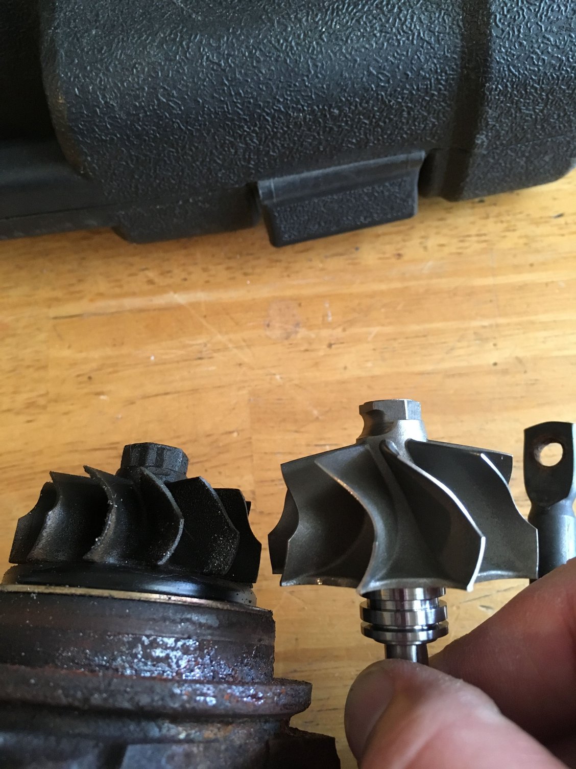

They use different turbine housing and compressor housing but the 14t chra and compressor will bolt too the 12T turbine housing.

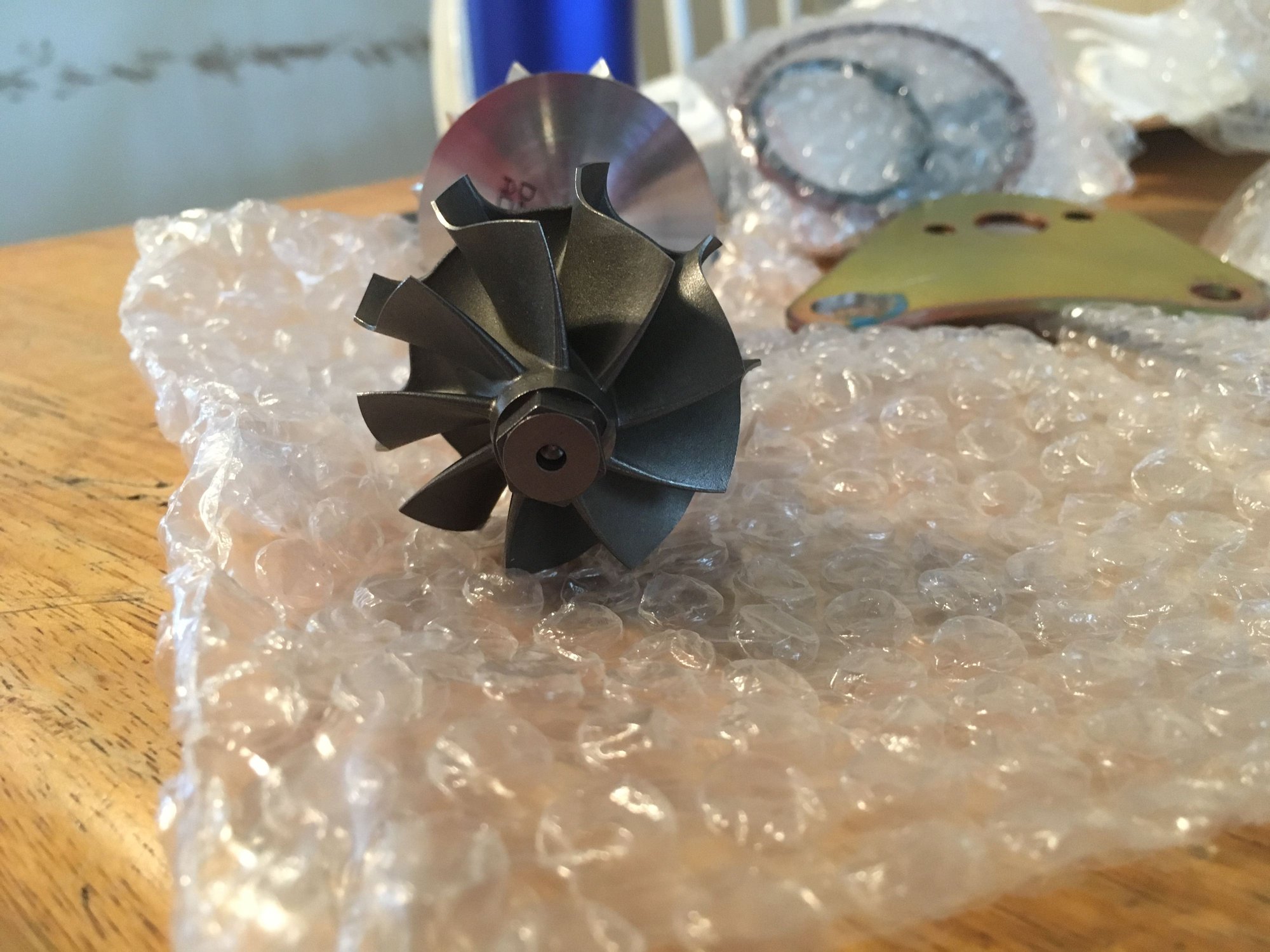

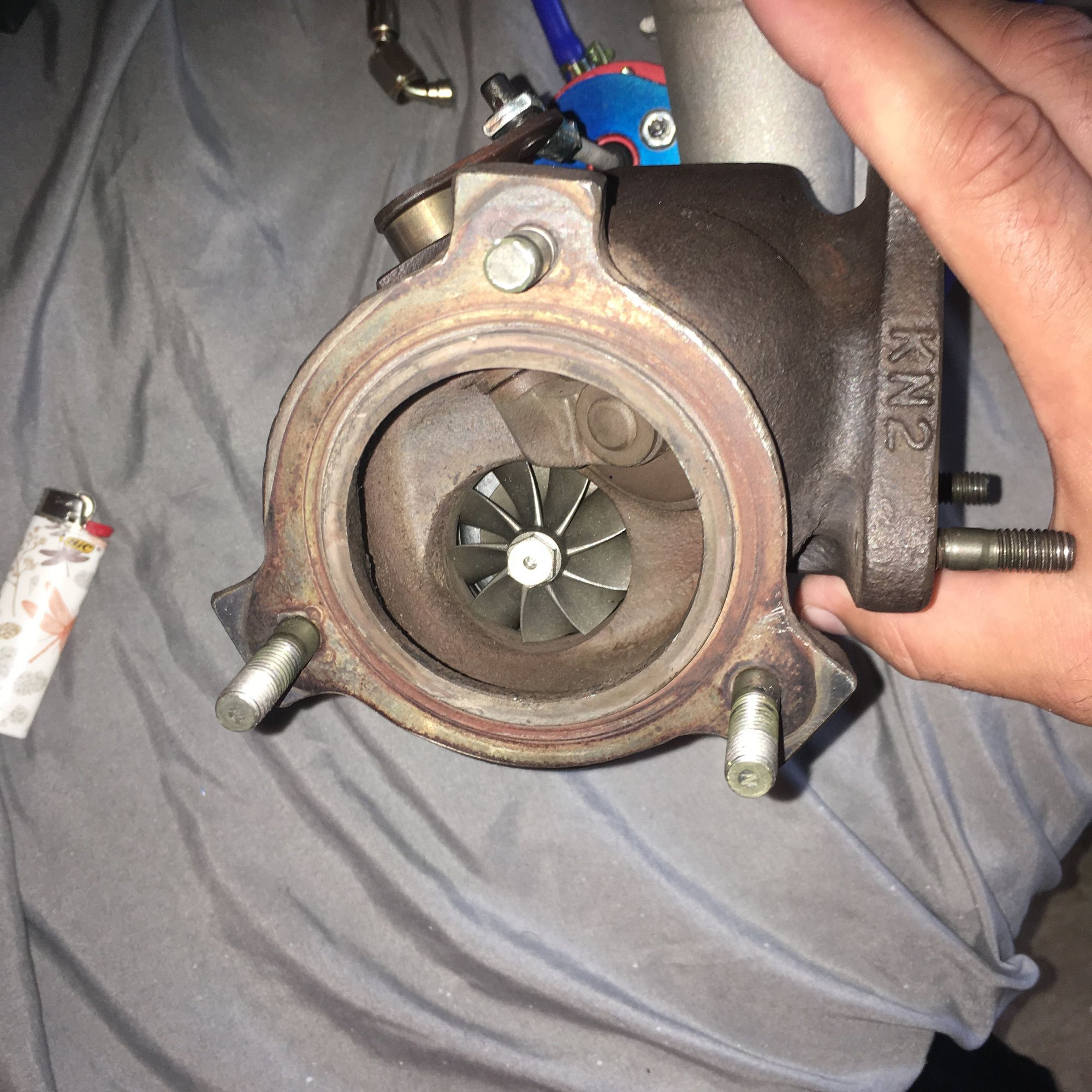

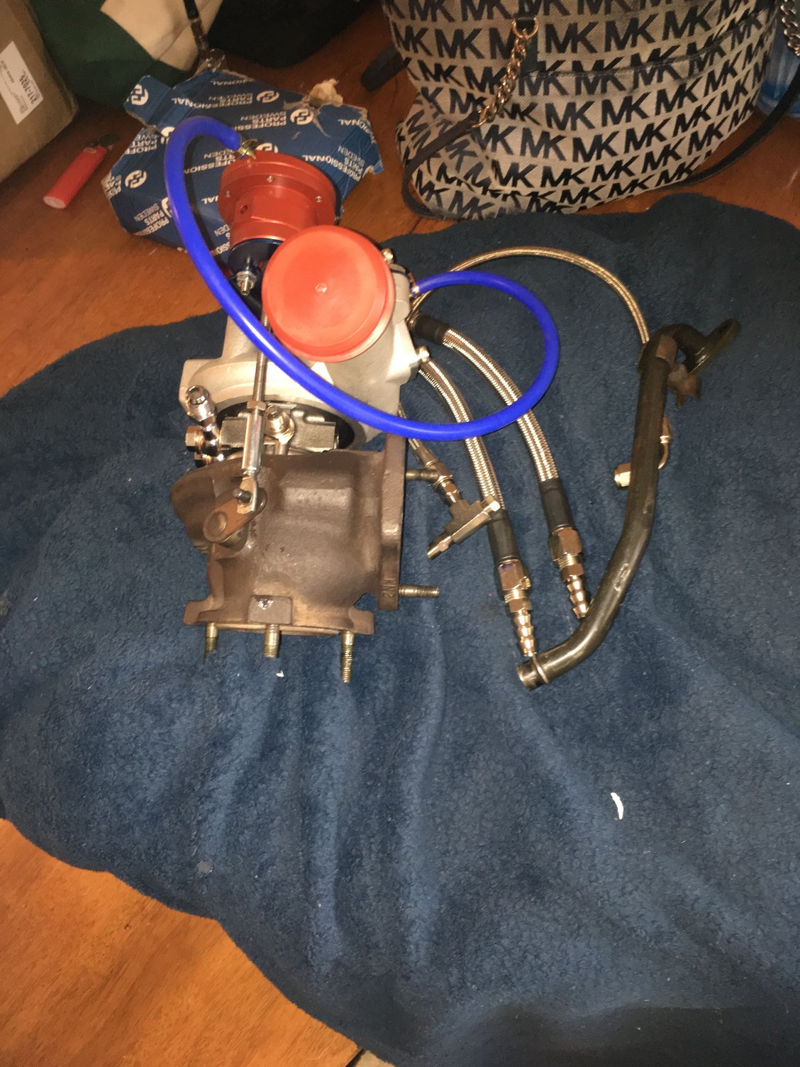

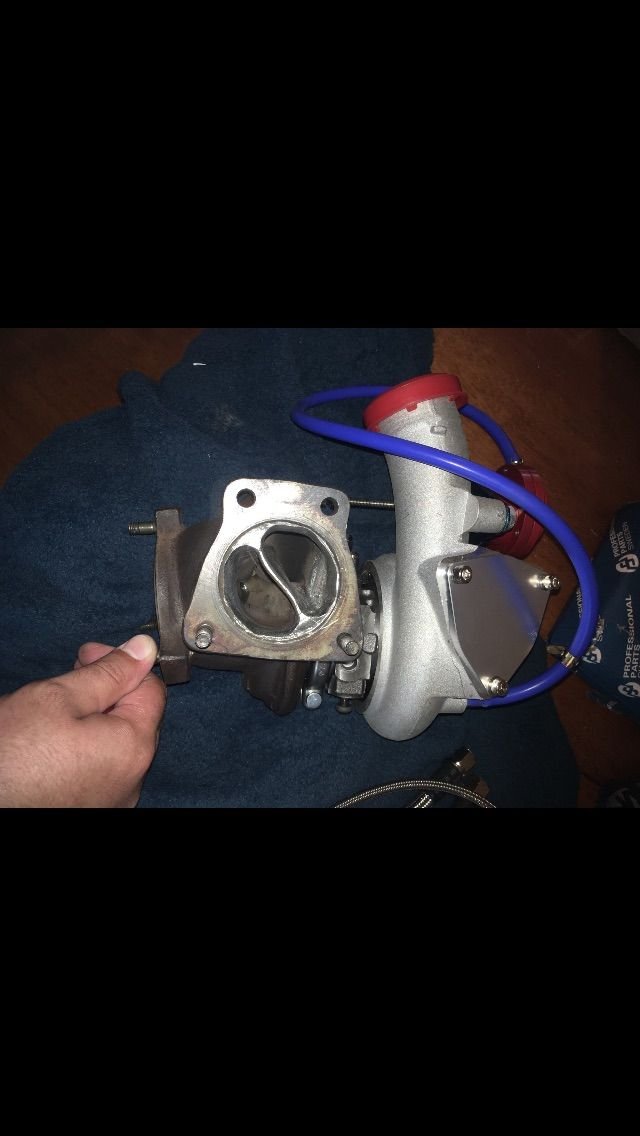

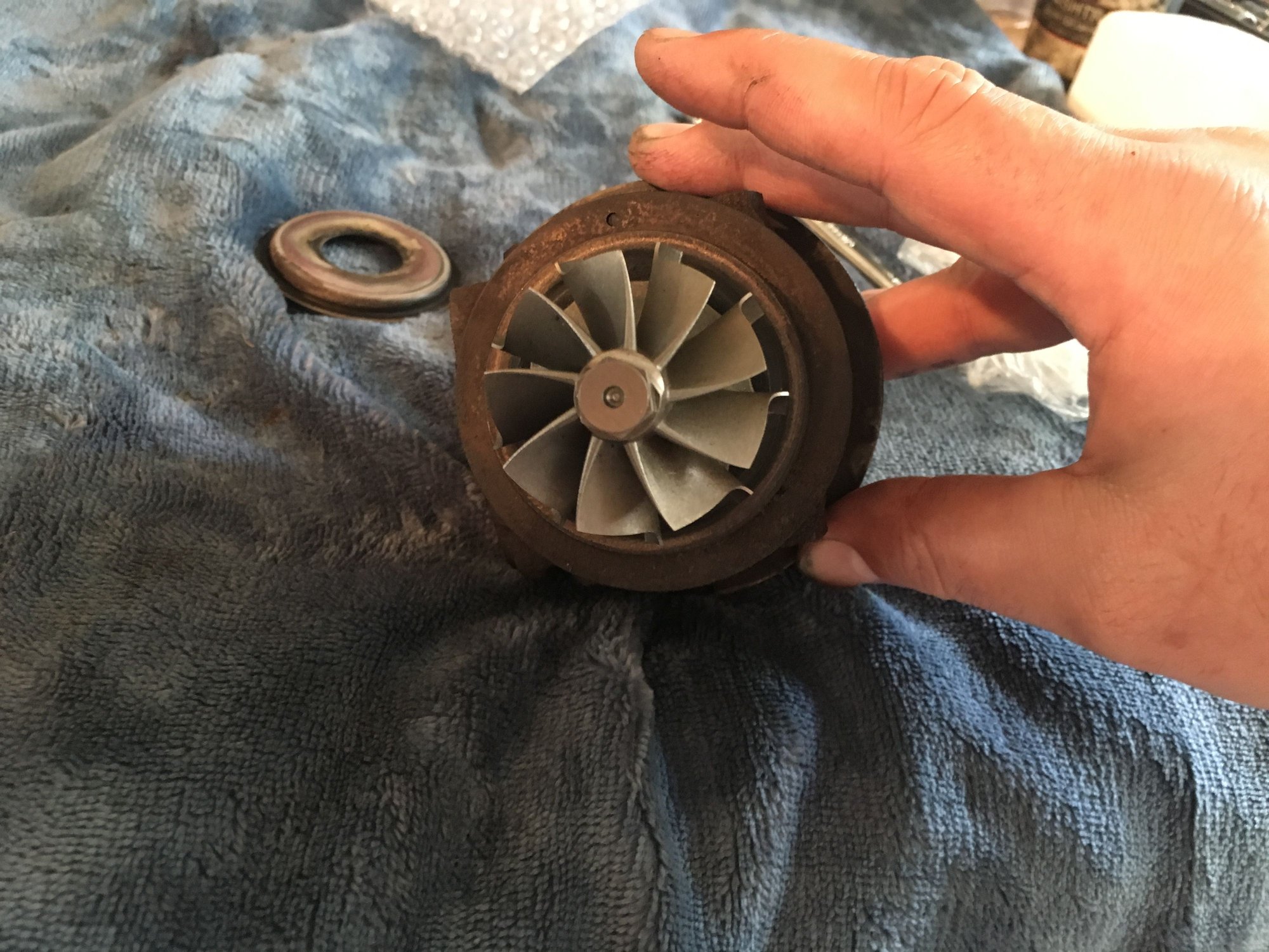

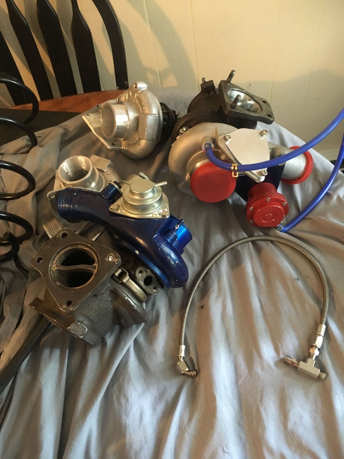

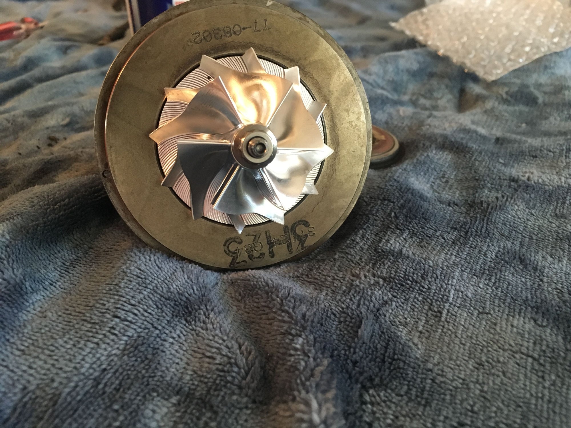

Any TD04L series turbo from12T-15T will swap over into stock turbine housing from 12T. The lager nozzle of the 14T does require you to remove the clocking pin from compressor housing to rotate towards firewall until itmatches up with charge pipe i used a aftermarket coupler and wastegate actuator so everything lined up perfectly. I bought a new 14T for a 2.5t s60 and used the mamba racing 9-6 stage 3 rebuild kit that has a extended tip billet compressor wheel 14T and lightweight highflow 9blade Td04l turbine amd forged thrust collars and surface with dual oil ports and step gap piston rings along with ported turbine housing and exhaust manifold and cbv block plate so i could run hks bov. Im running at 10psi with no tune and the actuator is adjustable till 16psi after a map from Upsolute i will run 15psi. If u just run a normal 14T a remap is not req
uired i also used all braided lines. Easy swapQUOTE=mt6127;479961]I've seen write ups where a 14T from a LPT S60 will fit but the housing needs to be rotated to allow it to align. I do like the idea of swapping the compressor/impeller into the 12T housing as that allows you to freshen seals and bearings via a TD04 rebuild kit. Even without installing an ECU tune you should get some performance benefits.[/QUOTE]
