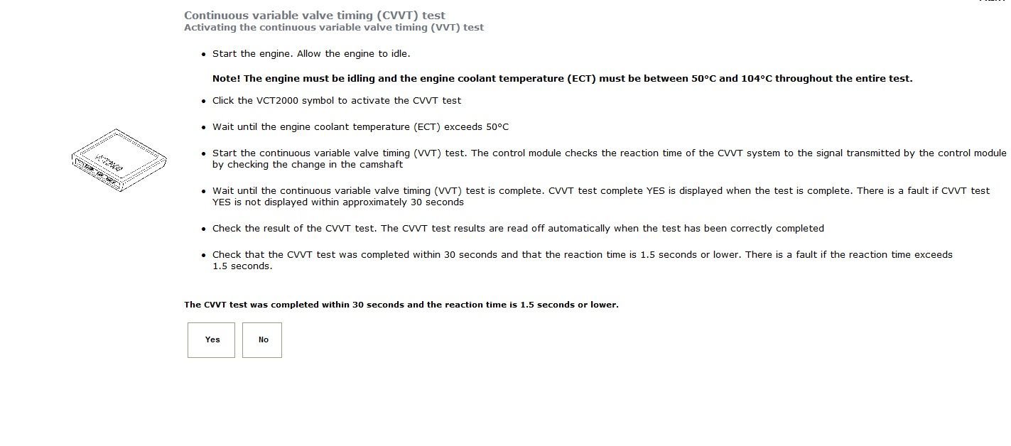

Actually it seems he has already tried to fix it and the problem is beyond his ability. You may have to find someone else who HAS the ability to understand how to diagnose what the problem is. Replacing parts on a guess is not the way to fix things.
Does your trusted mechanic have a tool that will allow him to test the VVT system? With the right tools you can actually figure out what's wrong -
