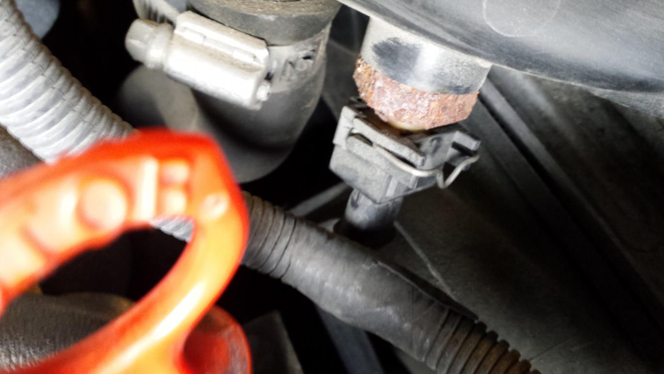

If you're looking at your map sensor on your intercooler, beside you map sensor there in a plug that looks like a bolt. Does anyone know what that is
Attached Thumbnails 2001 S40 Troubleshoot, CEL, Service Light,  Help???-20141017_143127.jpg
