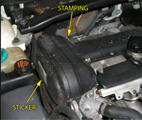

Now to the pertainent question - how to know which motor you just installed? There should be a sticker on the front of the timing belt cover with the B code (ie B4204T). If you can't find that, look on top of the engine for a machined stamp (hard to see so you may need a bright light) on top towards the firewall by the #1 cylinder.
