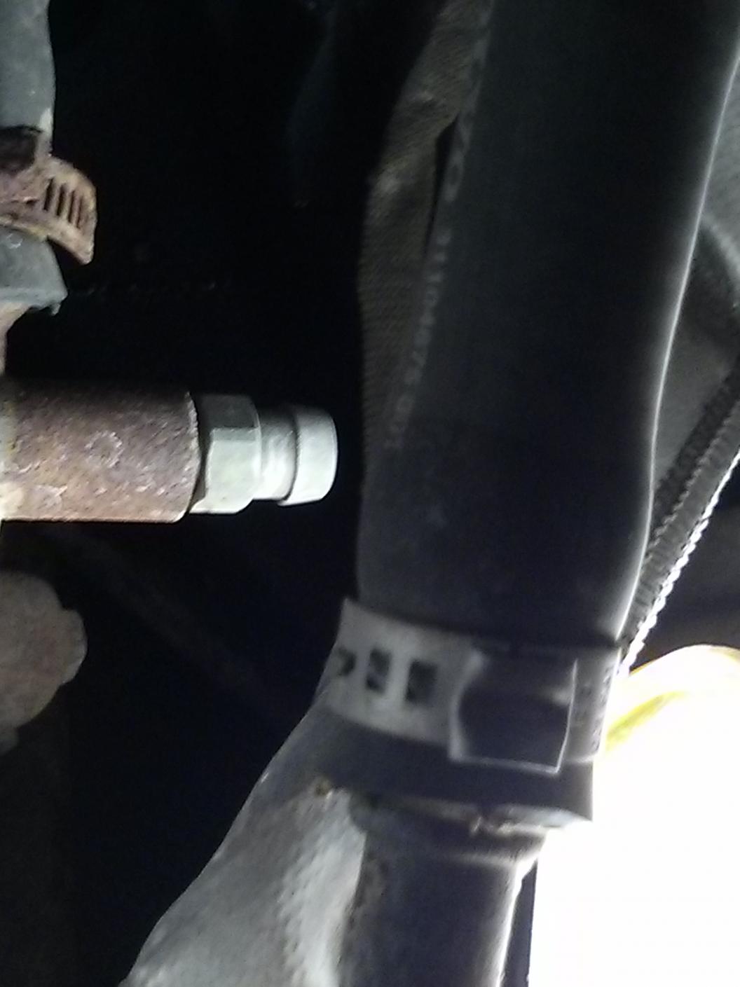

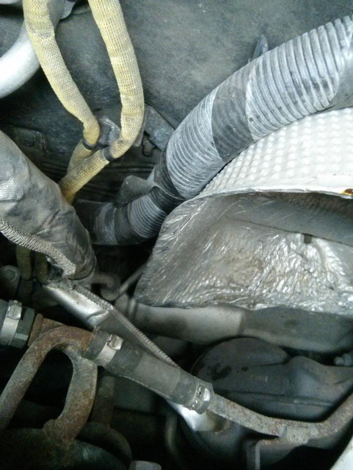

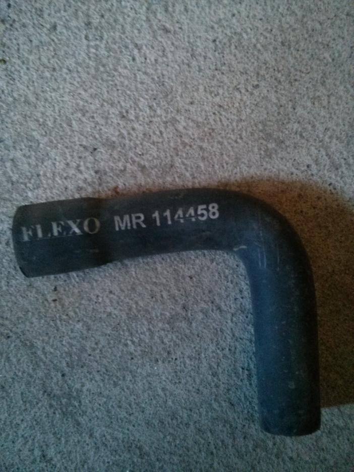

Old May 4, 2014 | 07:05 PM
dcjcdc's Avatar
Joined: Jan 2006
Posts: 109
update while changing tires today...loked under car and I see a hose missing..im pretty sure its missing..and also saw a small hose from the wall of the car by engine..not sure if these two should be all one hose,,,so put tape over one end as was told might be vacuum leak,,and the car started better...

Old May 4, 2014 | 07:46 PM
Hudini's Avatar
Joined: Oct 2007
Posts: 2,839
Likes: 17
From: Shanghai, China
Picture number 3 is the coolant drain fitting for the block.
Not sure where the hose is from. There aren't any vacuum hoses in that area, only coolant and oil.
The nearest vacuum hose is on the other side of the turbo.
Old May 4, 2014 | 10:23 PM
dcjcdc's Avatar
Joined: Jan 2006
Posts: 109
Default resonse
the hose in the 2nd pic is from the 1st pic...where the yellow braided hose,,there is a spot where that hose belongs to,,i just took it off, but put back on later
Old May 5, 2014 | 12:47 AM
migbro's Avatar
Posts: 732
Likes: 6
thoughts
...so put tape over one end as was told might be vacuum leak...and the car started better......lol
That tube is the drain tube for the air conditioner evaporator.
You should stop mucking around before you hurt yourself.
