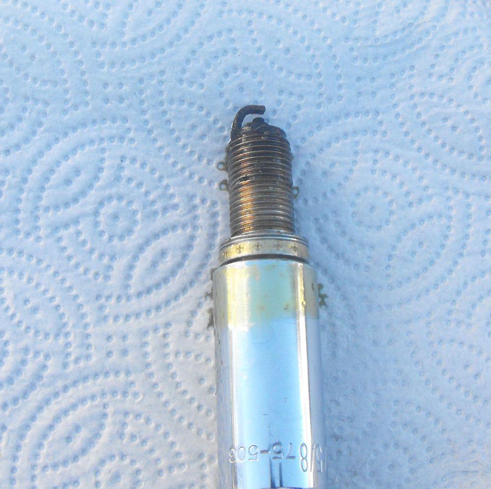

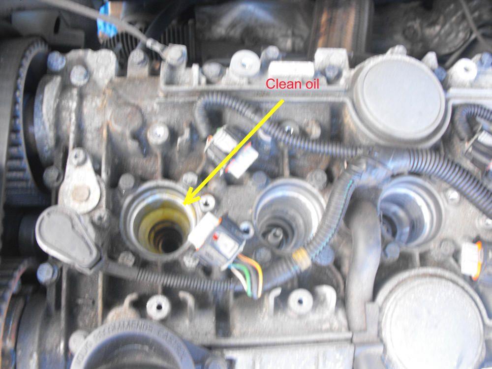

First I wanted to check if it is a rod knock and tried to remove sparks, manually crank and check for damaged crankshaft bearings, noticed that the sparks plug area of first cylinder is covered with oil, so was the spark plug itself as photos below show:
The oil on spark plug and it's surrounding area is clean, checked the engine oil, it is low and black dirty.
I appreciate any hint as what could cause so much oil in one cylinder and how it may relate to engine knock.

:There shouldn't be oil in the spark plug cavity, so my guess is that the plug was simply loose, and the "knock" you were hearing was just exhaust gasses bypassing the plug. I don't know how long those plugs have been in there, but it might be a good time to swap 'em out for some new ones (after verifying that putting the #1 plug back in properly stops your "knock".
At least, that's the best possible scenario. ;-) There certainly could be a real knock in your low end, in which case it would be totally unrelated to oil around your spark plug (and for which a new set of plugs would be a total waste of money).

I happen to have a set of plugs, so I am going to change it and the dirty oil and hope for the best scenario .
If knock prove to be at low end as you mentioned and I needed to change crankshaft bearings, why changing sparks will be a waste of money?

Sorry for any confusion - lots of folks would just opt for a boneyard engine, or even scrapping the car if they have a fatal flaw in the engine. If you are planning a rebuild (if the bottom end is toast, that is) then yes, new plugs are just part of the investment in getting that engine back to as-new condition.
Thing is, I'll bet dollars to donuts that the engine will be nice and quiet with that plug put back in correctly (or a new one, either way).

I would after I am done with oil pan that now I started to remove. Drained the dirty oil, have another S40 that runs perfect at 140000 miles and this one is knocking loud at 123000 miles, so I rather see how dirty oil pan is and check bearings by hand( did not notice movement from the top with sparks out),
The clean oil on corner spark plug should have been just oil spill when someone was adding oil because the oil cap is next to this corner spark plug.
