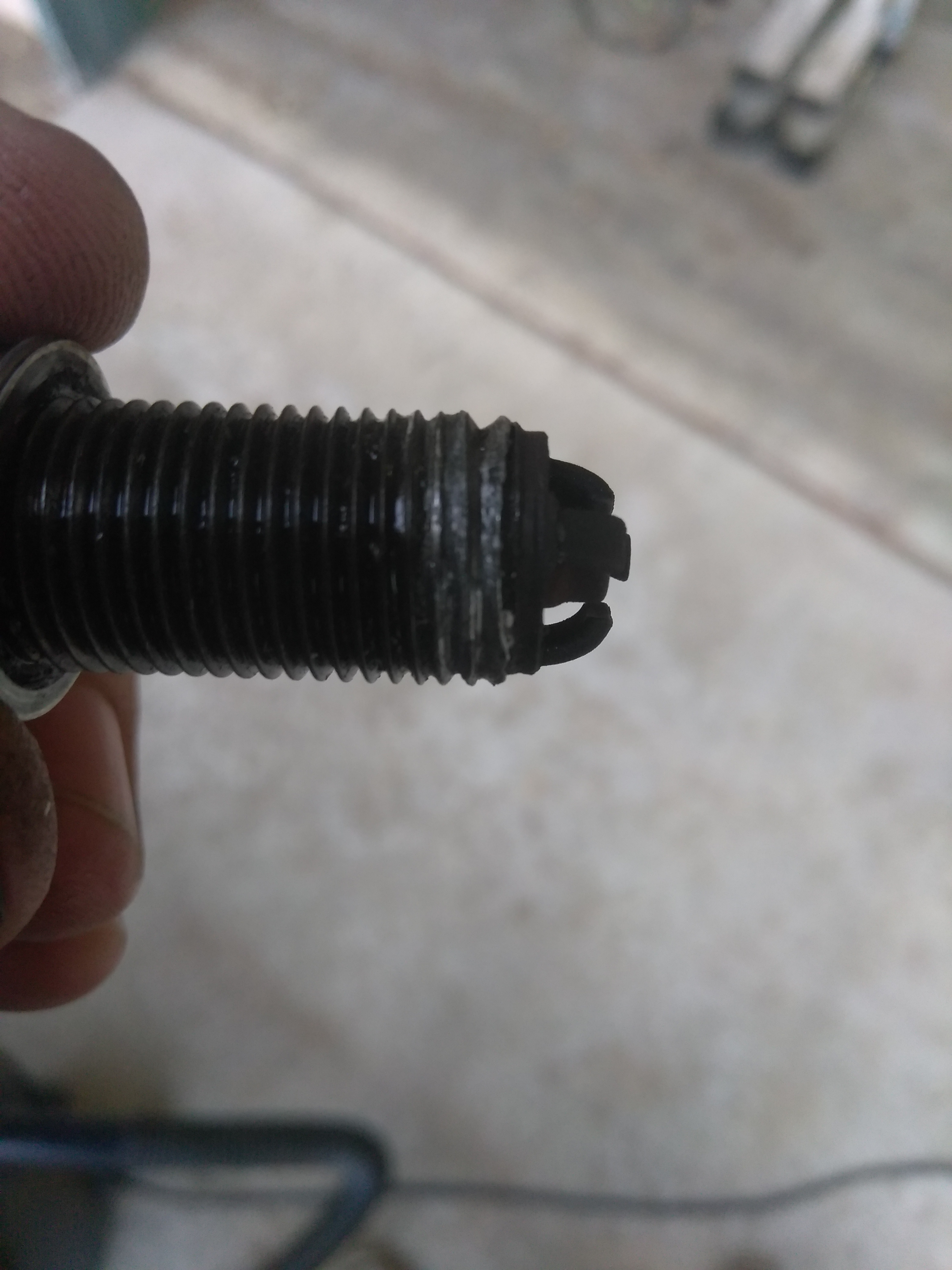

Today I went back in and got that stuck spark plug out. It was extremely tight almost all the way out, and when I got it out it was obvious why... the threads at the bottom were totally smashed. I have no idea how someone got that spark plug installed that way, must have used a power wrench and just forced it in. Photos attached.
Looking down the hole it was obvious the threads in the head were pretty screwed up. I went and got the thread chaser I linked in my last post above, turned out to be $10 well spent. I put some grease on it to catch all the metal shavings and crud, and carefully put it down the hole. It went down pretty smoothly without too much resistance, and it came out covered in both fine and coarse metal debris. I cleaned it up, put more grease on and ran it down again... this time I didn't even need a wrench, finger twisted all the way down. It came out with just a little debris on it, so I called it done. I vacuumed out the hole with a micro-attachment kit on a shop-vac.
After that the new plug went in nice as could be.
