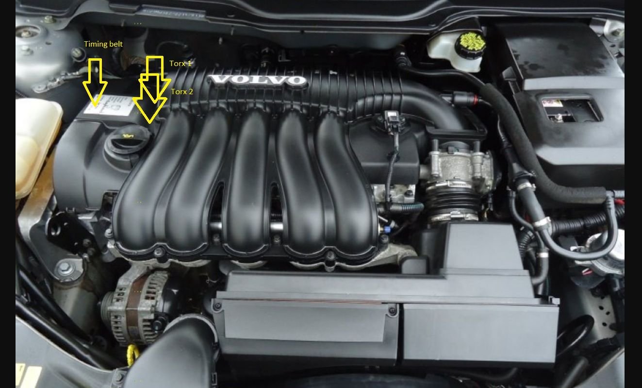

Hi
You can check easily the timing belt removing 2 torx bolts and see the timing belt condition. It should not be loose. There is other way to check the specific timing belt position, but it will be neccessary take out more pieces.
