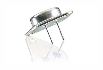

The A/C-heater fan blowing high at all times is usually the blower motor resistor. If you like saving cash then replace the old transistor with a Radio Shack part. It's not as robust as the OEM unit but will last a year or two. Plus it's like $4.
Here is the resistor with attached electronics and heat sink. Last I checked it was about $100 from the dealer. It's located behind the glove box inside the ducting beside the cabin air filter. Check your filter while you are in there.
This is the Radio Shack part 2N3055 NPN:

Thanks Hudini. The transistor was bad on the blower motor resistor. We tested it after it was removed. Can you tell me which wire goes to which transistor leg? There is a black and a blue one. Also, when I turn the fan on say number 2 now, on ocassion it will speed up slightly then slow back down to the speed I had it on. Is this a concern or is it because I bought the 15A from RadioShack instead of installing the 30A part? I noticed online I can get the 30A. Do you recommend I order the 30A in case this one goes out? I sure appreciate all of your help!!!

I don't think it matters which leg is which. I would buy the heavy duty part if it's not expensive. The Radio Shack part I installed lasted a good 1.5 years before it failed.

Any ideas about the 'surging' of the fan now? I can have it on 2 and the direction of the blowing at my feet and it will run at an even speed but suddenly 'speed' up for a second then go back down like it is quickly blowing out all of the air. It does not always do it but often it does. And it can do it for several repeats.

It's probably the resistor. The Radio Shack part is most likely the lightest duty one. Searching online I've found many of the same type non-polarity resistors.
