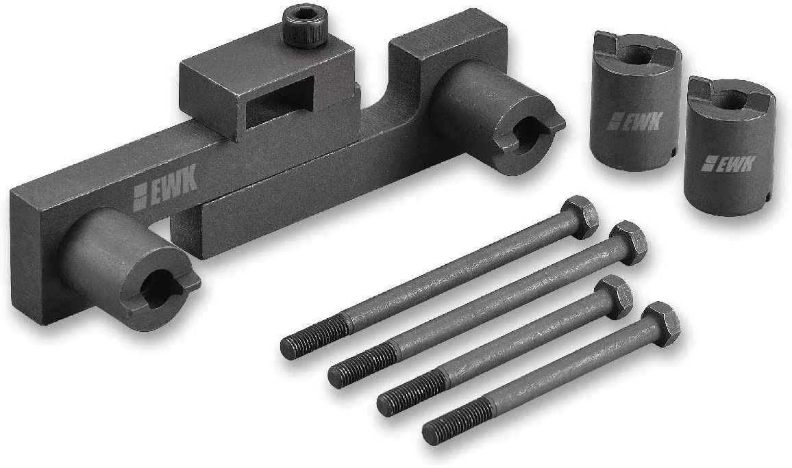

Originally Posted by Ut4life58
Then go up and put the cams in and top plastic cover to line them up?
You will need to have a cam locking tool like this one - to be able to reattach the VVT cam Gear/s and keep the cams in the correct position.
first off thank you for your help buddy. Also I want to correct myself. Not taking the timing belt off. Just the pulley to see behind it and line the marks up. I got the nut off yesterday before having to get some sleep before my night shift. Today I got a pulley puller set but didn't have time to get to wrenching in it. My understanding of the tool pic you sent was if you have the sprocket off the cam shaft. Am I wrong with this. My problem is the cams right now when put in place off 2 lobes on each shaft hitting the valve followers and not allowing it to sit down all the way. So I'm concerned about trying to pull the cam cover down on them like that. Once I have my marks on the crank lined up is this tool what I need to do that or is that for the cam sprockets? Thank you again for your help.
