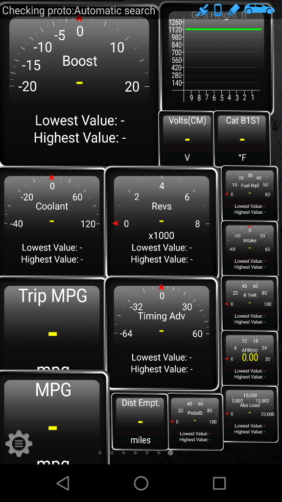

Yeah, I geek out about stuff like that. Using the Torque Pro app, a Bluetooth OBD "dongle", and my 'droid phone, I set up a custom dashboard that I used to monitor all kinds of data when I'm road tripping. One of those things was the throttle position, and it's pretty clear that the cruise control has a much "lighter touch" than my own right foot. For all I know (usually not much) the cruise control might not even move the accelerator pedal (and sender) to set the speed - I've had so many cars, I forget whether or not the pedal moved in cruise control (it does on some of the cars I've owned). If it doesn't move it, then I'd say you're 98% likely to fix the problem with a new accelerator pedal / sending unit (about $50 delivered for a used eBay example).
FWIW, here's a screen shot for the "dashboard" I set up for my Audi A3...

I think i'm going to steal your torque display. I've had that app for a while, but i don't utilize it as much as i should. Right now i just use it to reset the codes on the fly. I know that's not the safest thing to do, but I'm not trying to pull over on some PA backroad at 6 in the morning. Also about to order a new pedal w/sensor. It makes perfect sense, when I got this car it surged a couple times while braking for stop signs. I chalked it up to my boot catching the pedal and havent had the problem since, but occasionally the acceleration does feel a little erratic. Usually sluggish. I also know I've kind of hijacked this post, I hope original poster still follows. I've seen the issue posted a few times and have posted myself in several FB volvo groups with no resolution. Was chatting with a volvo tech about it for a bit. It's on the verge of becoming my white whale. lol
