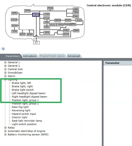

A good first step would be to scan the CEM with a compatible scan tool. And with that tool you can check the status of what the CEM thinks is happening. It's possible that a problem in the CEM is the culprit - a company such as xemodex.com can solve that cheaper than a new CEM from Volvo.

I would imagine a typical Autoparts free scan would be for OBD/emission problems only (so they can suggest parts to sell you) and those tools are not advanced enough to talk to all the control units shown in the diagram above.

Ideally, you get VIDA installed on a laptop, and work out all the details for the cabling and operating system, etc. (and it can be "interesting"). That gives you a huge resource that will make working on your Volvo a whole lot easier in the future, though you may suffer in the short-term.
Or you can find a quality Volvo-specific two-way scan tool. I've had good luck with the Autophix scanners (the 7110 is the one for Volvos). It will talk to / monitor pretty much all of the systems in your car, and should give you a whole lot more actionable data than a parts store generic OBD scanner. I haven't owned that scanner, BTW, but have had one for my BMW (just sold it) and my current Mercedes (works like a champ for that one).

I believe the low beams are relayed via the CEM. What I'd do first is check the socket - power? ground? then I'd work back to the CEM.
