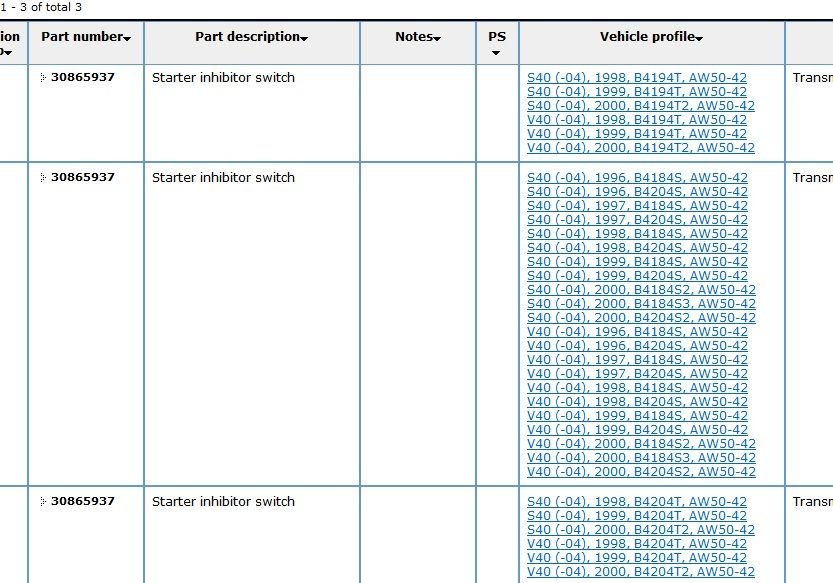

That starter inhibitor switch only fits sv40 up to 2000. Googling that number finds switches with and without a short wiring harness - Which does the OP have? The switch with a short harness appears to be discontinued -
