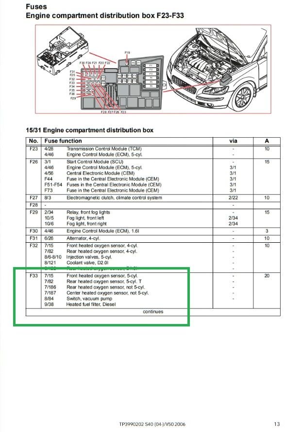

Yes, the non-turbo cars have three O2 sensors. (turbo cars have 2) If your codes are all O2 heater codes - power for those heaters is from fuse 33 in the fuse box shown below. That fuse also powers the vacuum pump. A common failure is the plastic vacuum pump switch breaks, causing the vacuum pump to run all the time, and the pump eventually melts/seizes and blows the fuse - for the pump the the o2 heaters!
Disconnect the switch/vacuum pump (or fix it would be appropriate), replace the fuse and the heaters should work again and after codes are erased they will not come back. (as long as the O2 sensors are indeed ok) . You typically are not going to have multiple O2 sensor failures. Is your fuse 33 still ok?

your car has two oxygen sensors a front sensor and a rear sensor and each sensor has two circuits - a heater element and the signal. The P0031 is saying the heater circuit on the front sensor is at fault and the P0147 is saying the heater circuit for the rear sensor is at fault. So per hoonk's guideance, you should be looking for something common to both such as the power to the heating elements. Fuses, relay, wiring. Since your car is a 5 cylinder and not a turbo, you can see which fuses are in play.

Yes the vacuum pump turn off switch is bad - that's what broke first and fried your old pump. The switch is part of the hose going to the brake booster. This MIGHT be the correct part, there are a couple of choices. Verify first - probably by using your local dealer to get the correct part number.
