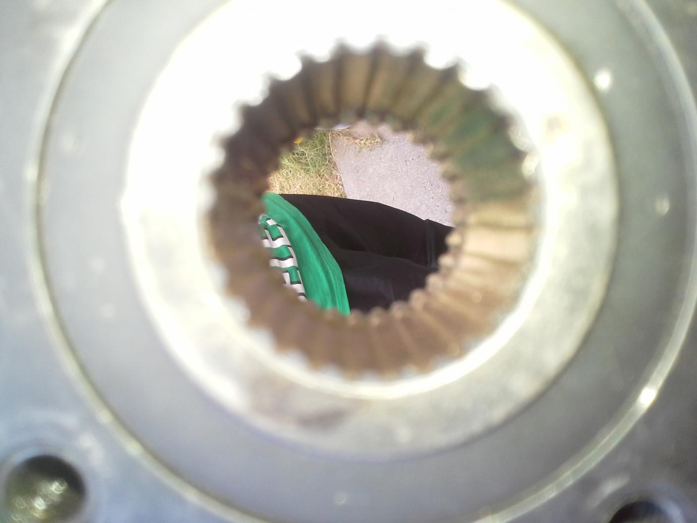

Old Jan 28, 2014 | 09:13 AM
shawnjonesec's Avatar
Joined: Jan 2014
Posts: 9
Some pics of my crank sprocket gear.
Old Feb 3, 2014 | 12:21 PM
Joined: Jan 2014
Posts: 9
Fitted a new crank timing sprocket and didi the rest and the car started right up.
Thanx for all the help. problem sorted
