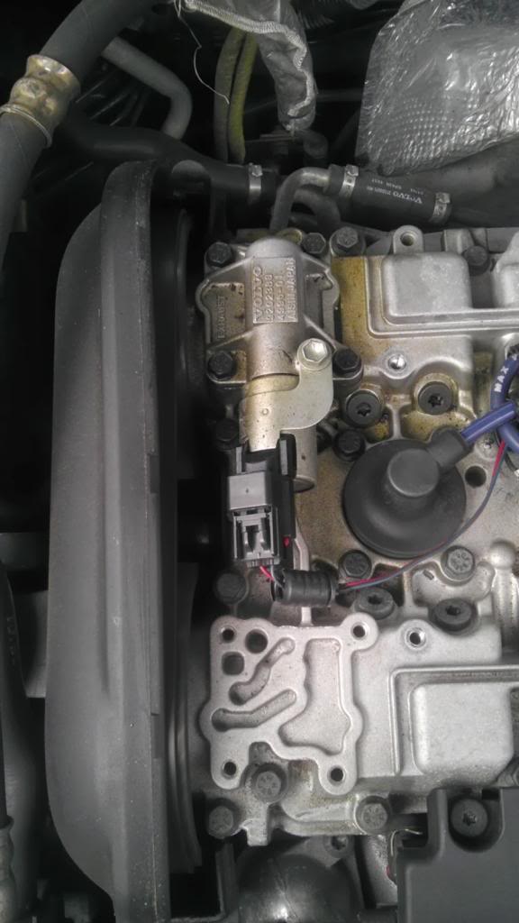

I was changing spark plugs and notice oil at the top of the head and it appears to be coming from whatever this is at center, left side of picture. The picture is looking as if standing on passenger side front wheel. The thing with the red and blue wire going to it. Anybody know what it is? I cleaned up the oil but those little reservoirs were full where it is stained brown.

possible cvvt leaking

That would be your cvvt solenoid. I haven't seen any of those leak only the front cam seal but it is a possibility

Thanks! What is the CVVT for? So it could be from the cam seal too? I haven't noticed any drips under the car.

Continuously Variable Valve Timing. Known by various other names with other brands like Honda VTEC. It uses oil pressure to advance or retard the exhaust cam through the cam gear.
Does your timing belt have oil on it? This is important because if it does you may have a leak in the CVVT cam gear itself which has been known to cause worse damage if left alone.

Thanks Hudini.. no, I do not have oil on the timing belt.
