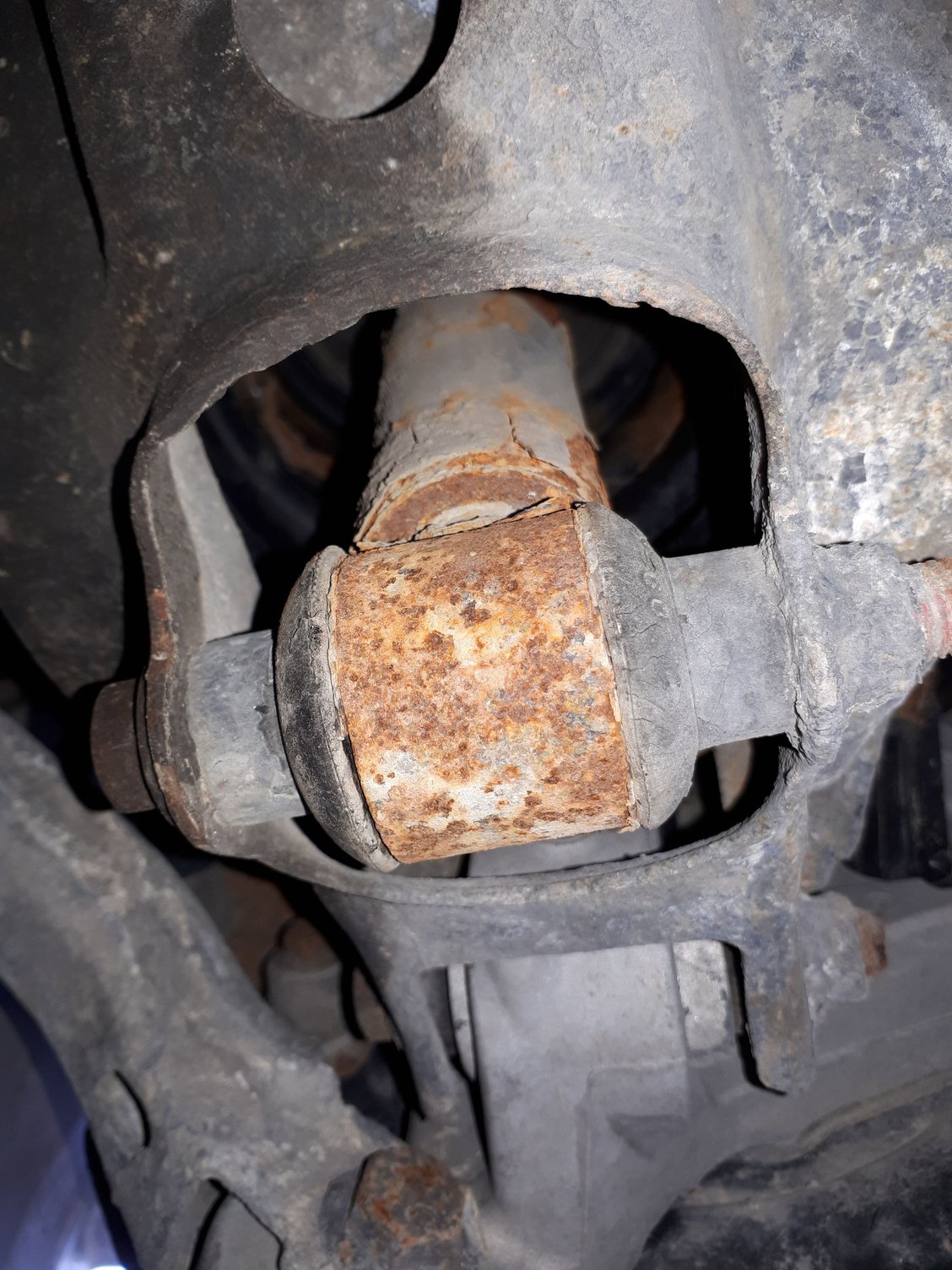

looks like the shock's bushing is worn (first pic). Did you also feel around for any looseness on the sway bar end link (pick 3)? Creaks are usually when the bushing rubber hardens up but I've also see springs make noises - particularly if they break off an end piece (common issue on the S40 Neds cars) There you'd get spring metal rubbing on the spring seats

I saw that bushing in the picture as well and double checked.. it was the wrong picture. (Absorber from driver side, and it is shot as well..) So, new shock absorbers soon regardless...

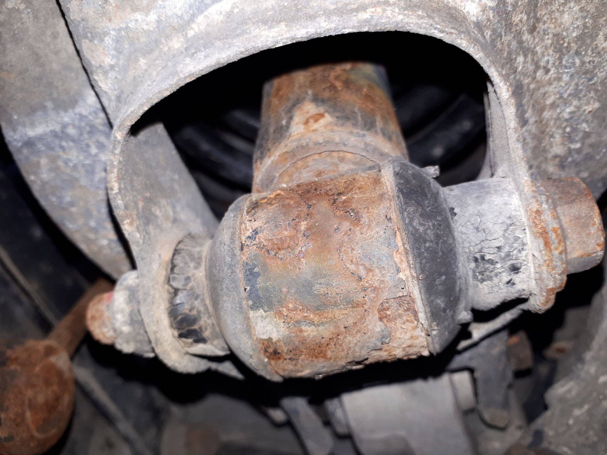

Here is a pic of the shock I'm hearing the noise from.

upper shock mounts are pretty easy to replace - hardest part is moving the trunk liner out the way! You'll find two bolts then the shock's upper nut. If you are to replace, then you might as well throw in new shocks at the same time since you need to drop the shocks out to remove the mount.
