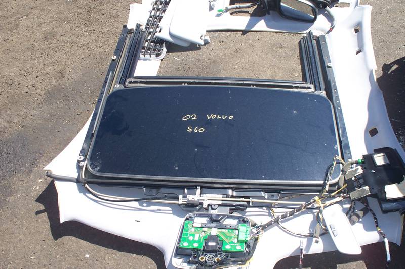

I have had the same issue on my '03 for a couple of years now but have not done it yet as I assumed that I had to remove the head liner to get at the slipping gear.
Please post your findings I would not mind getting it fxed myself eventually.
See the picture of a junk yard sunroof
