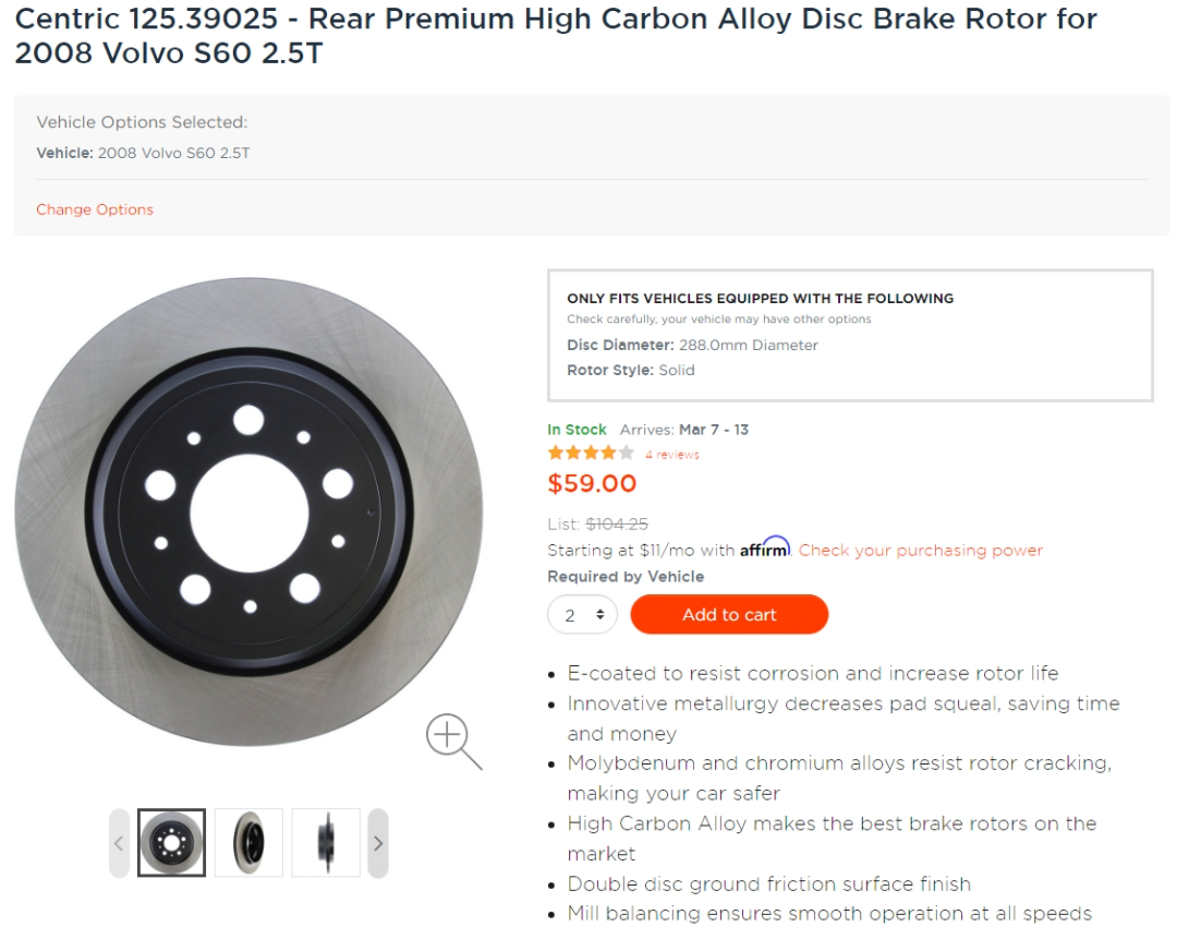

  • These are the parts I used in the rear:
Ceramic Brake Pads (Rear) from Akebono
High Carbon Brake Discs (Rear) from Centric
