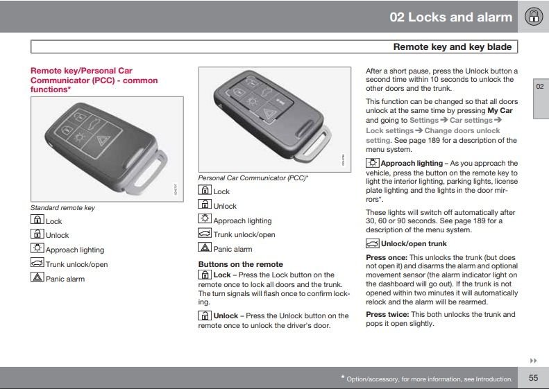

Are you saying - the physical emergency key, when removed from the remote and turned in the drivers door tumbler does not unlock the drivers door? (and will electrically unlock the other doors/trunk if working properly)

Usually, as long as the key is on your person, you should be able to unlock and open the door by placing your hand on the handle.
Old Jul 7, 2022 | 04:53 PM
Yes if you have the optional six button remote, (the "personal car communicator") the door should unlock if the key is close enough to it. Do you have the five button or the six button remote?

Yes. The 6-button remote works fine. But I cannot unlock the door at the door handle. Even with the remote in my pocket.
