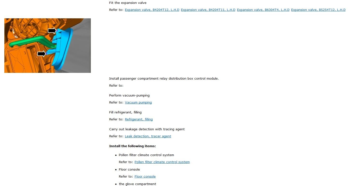

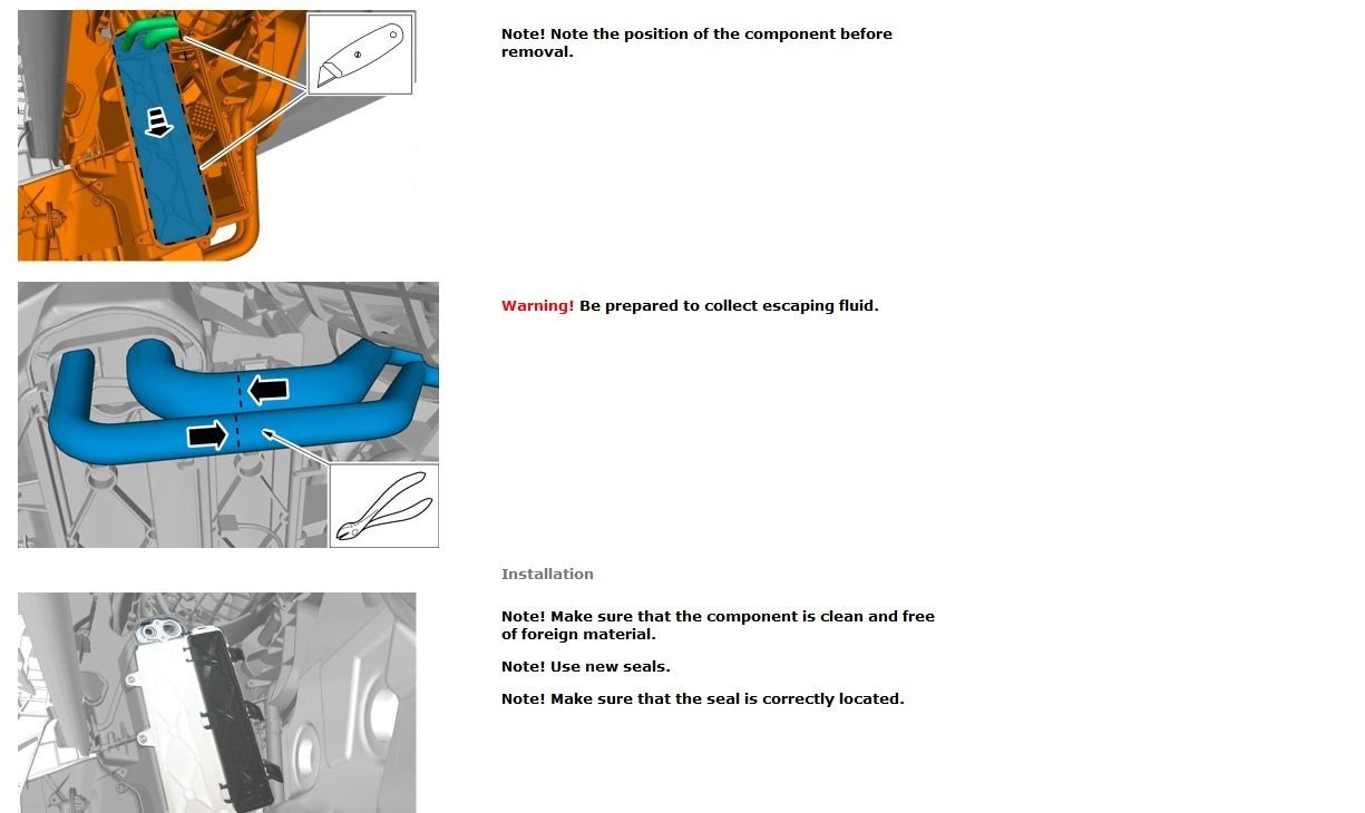

Here's the info in Vida 2014d for a 2015A V60. Does not look too bad - as in you don't have to remove the climate box to get to it as you do in many other cars. Google the part number - looks like you cut the old pipes and the new the pipes unbolt from both ends of the new evaporator and it comes with a replacement door for the one you cut in the climate box!

Update for the benefit of the group. The evaporator core was leaking. I tried several indy shops in town, and their systems all had labor for the job but none of them had the instructions. Finally Christian Brothers at least went the extra mile to FIND the instructions, and did the work. As @hoonk alluded to, the part is not designed to be replaced. They had to cut it out of the car, and then cut it out of the climate box. The replacement part comes with a screw-on "patch" panel to close up the box. ~$2,100.
