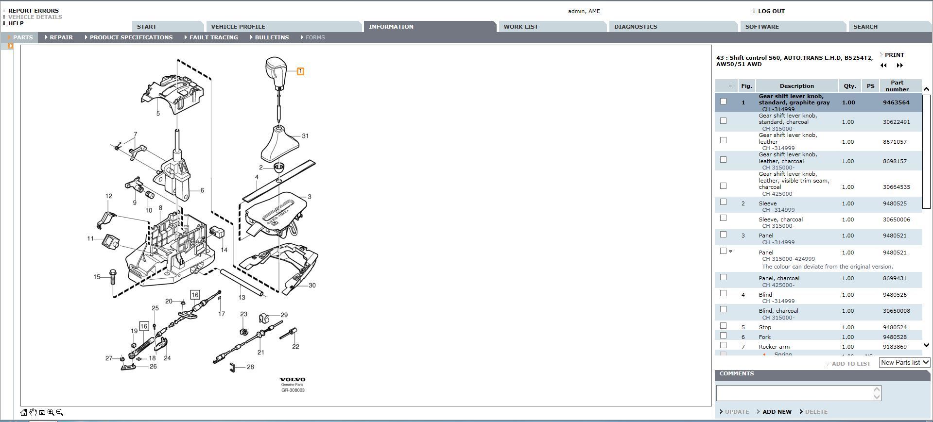

Hello. I bought a 2003 s60 d5 Auto about a month ago.
Sometimes I have problems with changing gear ( auto GEARTRONIC box)
The lock won't lift sometimes.
The problem is the black mechanism behind the button on the gear ***.
Sometimes the rod jumps out.
Is it possible to buy that only or do I have to buy a complete new stick?
The **** is good The button is good and the lock pin is good.
Thanks

If you're looking for a part inside the gear shift **** it looks like only the **** can be replaced not the internals within it. But that's just based on what I see in the part breakdown on VIDA. I've attached a screenshot of the parts diagram for the shift ****.

Thanks, Wampo.Volvo would only sell me the gearstick complete. Fixed now got the part from a breakers.
