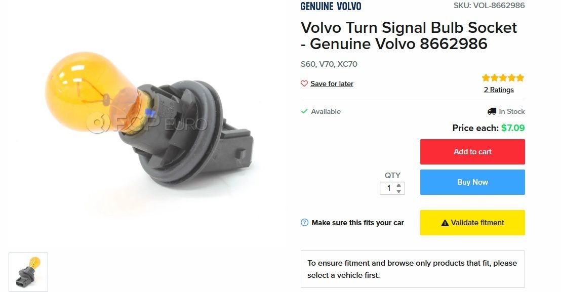

Your car does not have a replaceable turn signal relay. It's part of the DIM (instrument cluster). Yes, years ago a turn signal relay/flasher unit was a common replacement - but not on your 02 Volvo.
If you only have a problem with the left side - The Front turn signal socket is a known failure item. To verify that you could try swapping the left and right and see if it follows the socket. (yeah, they are not easy to get to!)

Thanks. If it was the socket would that cause the ticking (i.e. the actual part in the DIM) to also be intermittent or fail temporarily, and stop the rear indicator light also? (i.e. rather than just affecting the front light bulb itself for example)

Answer the question by swapping left to right or replacing the socket.
