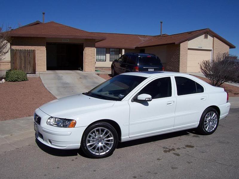

by the way, you have two garages on the opposite sides of the house?
where do you live?
Arizona? New Mexico?
