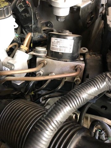

@MAXRED, I believe I finally fixed this by replacing the ABS valve body with a used unit I ordered from a parts yard in DFW area I found online. That was in May 2020 and the problem has not returned (fingers crossed).
Not a terrible job replacing that unit and I only had to bleed the hard lines at the ABS valve body when done. I kept my original motor that mounts to it.
The first time this problem occurred (at Sam's drive-through - stuck for about an hour) I cleaned calipers/pistons, inspected soft lines and replaced fluid but it happened again shortly.
Second time it happened (in driveway) I replaced booster and master cylinder. Replacing the booster was a tough job and it didn't happen again for a few months so I thought it was fixed.
Third time it happened (a couple of blocks from home) I replaced the ABS valve body.

ABS Valve Body
Old Mar 16, 2022 | 11:03 AM
Likes: 540
to note, on my Volvos (850 and S40 Gen 1), the ABS pump, valve body and controller can all be serviced independently. I too had a RR lock up where no fluid was getting to the FL wheel (pushing too much to the RR). Replaced the valve body did the trick - and I kept the existing pump and controller. I think I paid $65 for a used part at a local yard.

I had this happen with my 2002 S60, the RF brake would grab hard enough to keep the car from moving and then release minutes later. My mechanic dove into the problem and wound up replacing nearly the entire brake system chasing a different problem. So I'm not sure what the problem was.
The initial thought was that the flexible line to the RF caliper had a defect that wouldn't allow pressure to release. However, in an attempt to flush the brakes, he found that the ABS unit wouldn't flush so he replaced that as well.
