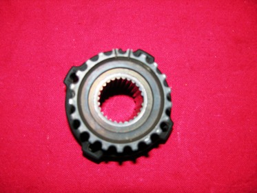

There are two short marks on the back part of the crankshaft pulley. They straddle the protrusion to the left- facing the engine. The problem you are having is with the variable valve timing on the exhaust cam. If you had the exhaust cam locked you would see that the exhaust pulley will rotate clockwise approx. 2-3 teeth. You have to advance the pulley with a torx socket on the front and then put the belt on. I did mine after a valve job so everything had to be reset. I don't know why you couldn't line up the crank and intake cam then mark the belt and the exhaust pulley where it is now and then move the exhaust pulley a tooth to the left if you think it's too advanced. Not the best way but without locking the cam I don't know how you would do it.

Here's a few pictures that may help. You may have to take the cam position cover off and see if the slot in the exhaust cam is straight across. Then hold it there while you advance the pulley and put on the belt.

and u have 2 timing markes on the crakes pully and u put the pionter in the center of the 2 thay will not be strate up and down will be at a 11:00 point and the markes on the pully are on the back of it
