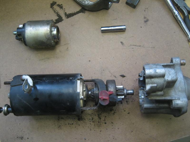

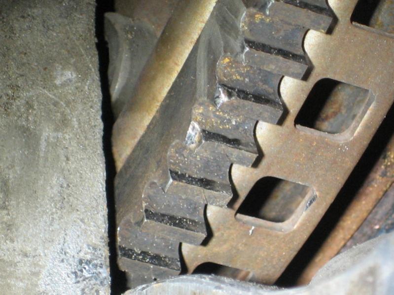

So I pulled the starter out today, and after taking the starter apart, found a lot of gunky dirt in the helix gear- that pushes the gear into the ring gear- so I pulled it apart and cleaned, re-installed and now I have no problems.
Note grime on helix gear
Starter taken apart
I was worried about some of the chipping on the ring gear- but after cleaning inside of starter I don't have the problem anymore.

That grime looks like ground up metal to me, but hard to tell from those pics. If that's the worst spot on your flywheel ring gear, then you're probably OK there.
