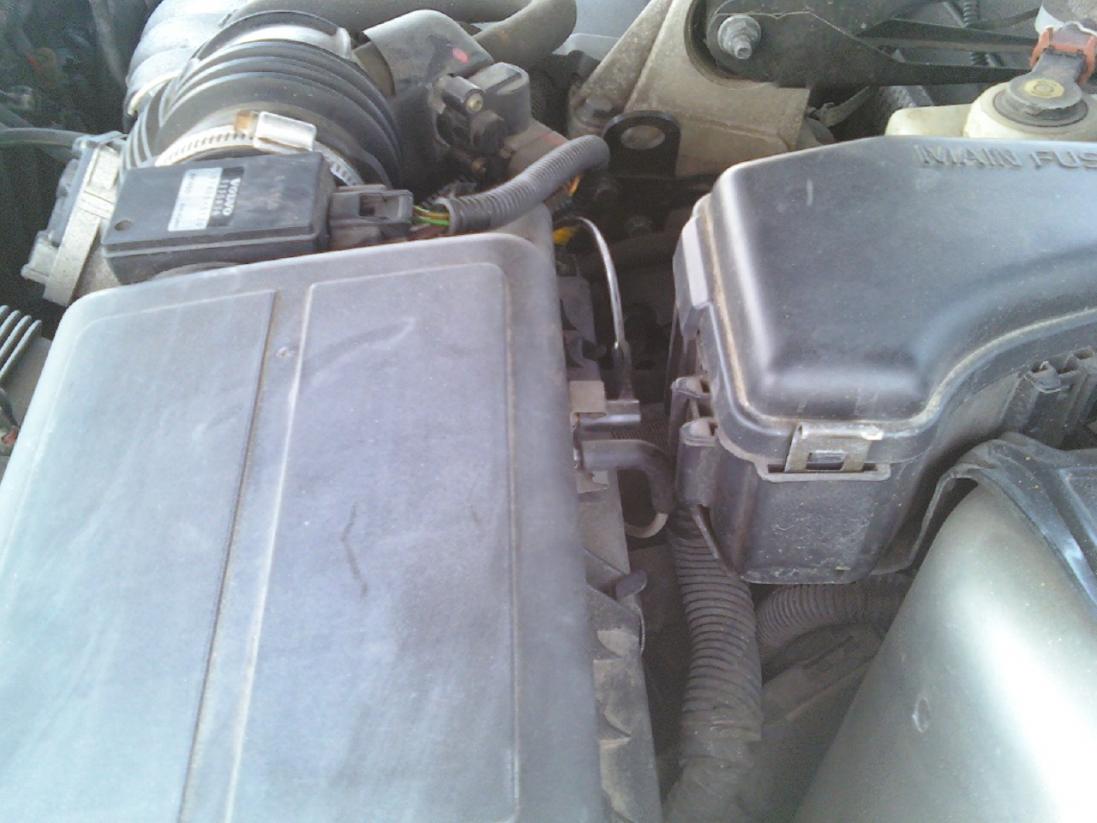

im a little confused...the back of my air filter looks different. im trying to do the custom intake as well and im not sure what to do with the two things in the back....mine is a 2000 s70 base

I believe those are sensors of some sort. TECH will be able to elaborate.

Don't do anything until you talk to TECH about it. Mine didn't have those, so I want him to check it out.

One of those hoses goes to the Valve in the air box that directs the hot or cold air into the air box.
The second one just goes to the intake. Not exactly sure why they have it there.
I would remove it and cap the port and see what happens.

the one that goes back to the box (the top black one)...just remove that?
and cap off the bottom white one?

When you remove the airbox the line will come with it.

ok but i dont understand what to do with the bottom one...what did you mean by "cap the port"?

Exactly as it sounds. Cap the port. Meaning put something over it to cover the hole that is in it.
like putting a cork in a wine bottle. Cap it.

Or remove the hose from the intake and put a rubber cap over the port you remove the hose from.
