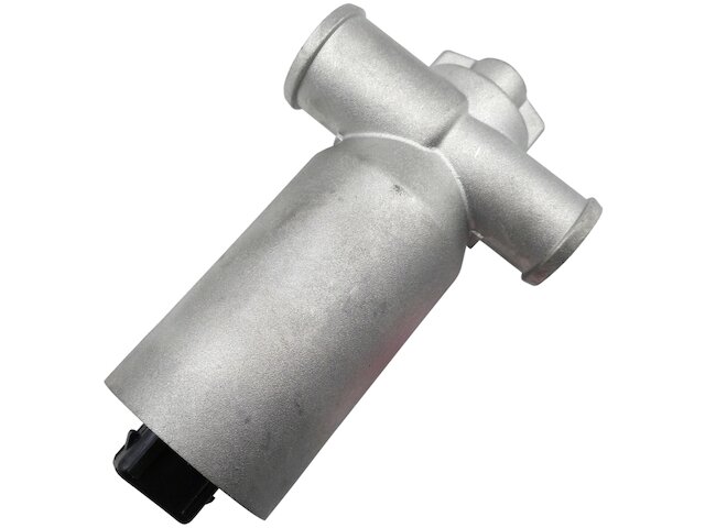

A 98 has a throttle cable - should be simple to see if it is sticking. The throttle position switch won't make the idle get out of control like that - but your idle valve/iac/idle motor/whatever you want to call it - will - they can stick - have you checked yours for correct operation?
Idle motor should look something like this
