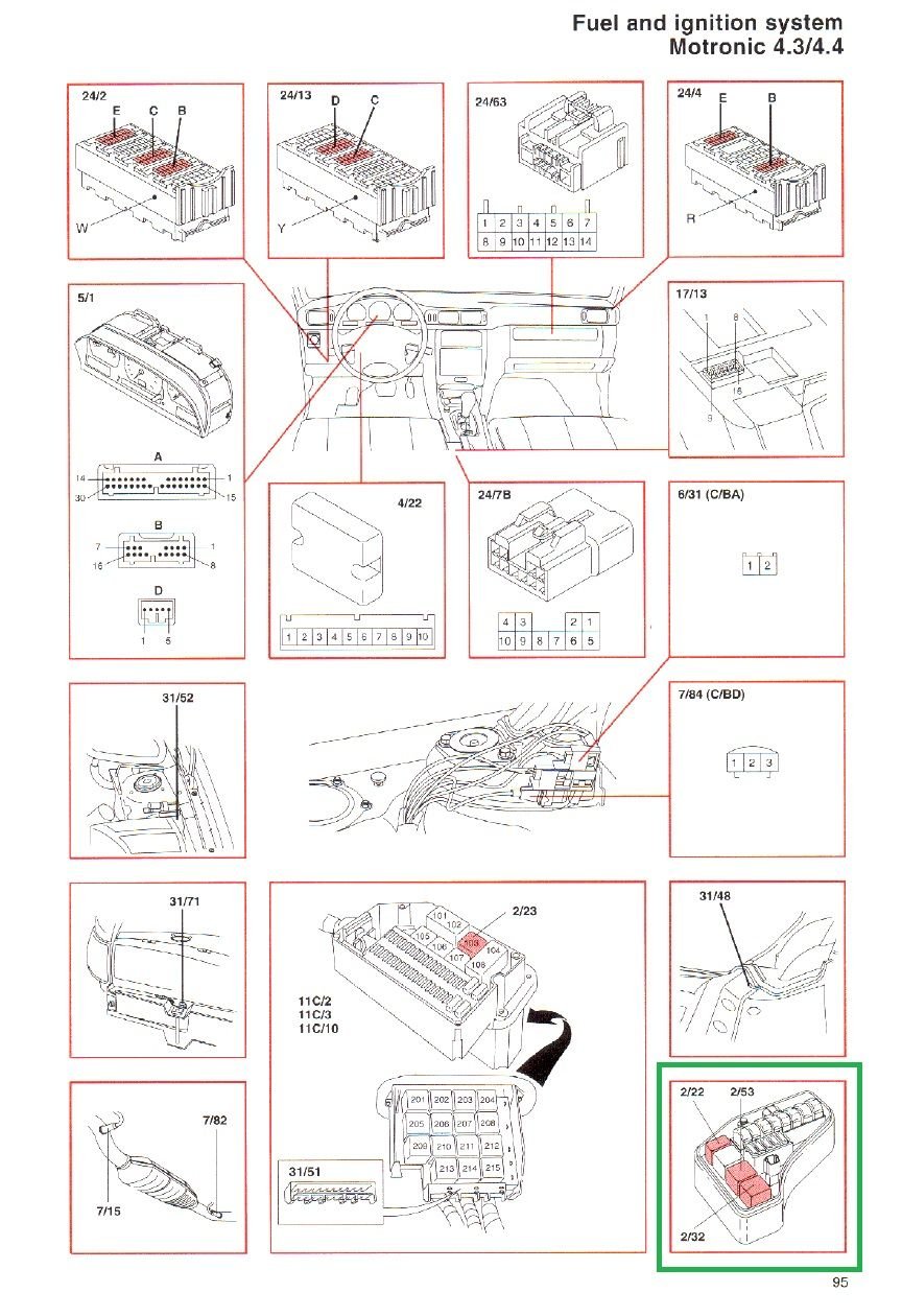

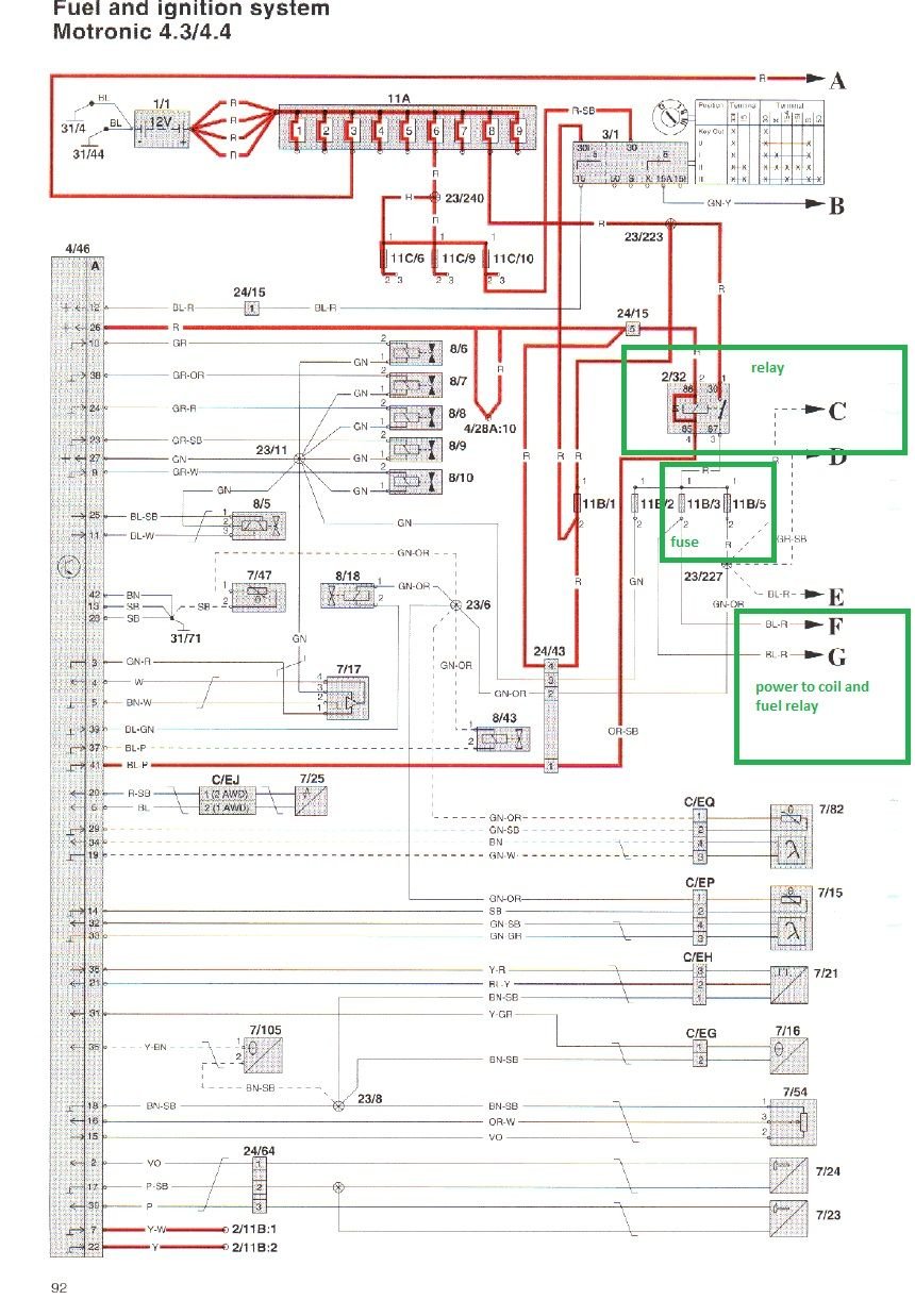

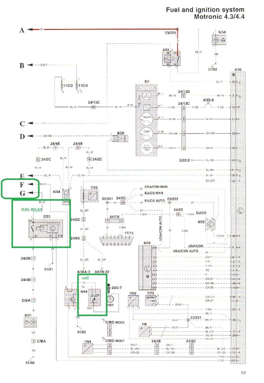

Power relay 2/32 provides power through fuse 11b/3 to the coil and the fuel system relay. Do you have power at fuses 11b/2, 3 and 5 with the key turned on? And 12v on one side of the coil?
