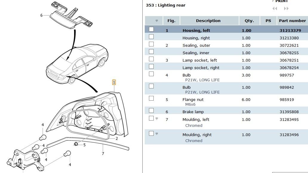

The brake lights will be the same brightness on both sides. If not someone may have installed the wrong bulb. The car does have a rear fog light on the left side - that is as bright as a brake light, and confuses some owners when switched on. Switch for it is next to the light switch (and front fog light switch) The parts catalog show 4 replaceable 21 watt bulbs in each tail lamp - yellow ts bulb, clear reverse, brake and rear fog. The 21 watt bulb is a standard 1156 single filament bulb either clear or yellow.

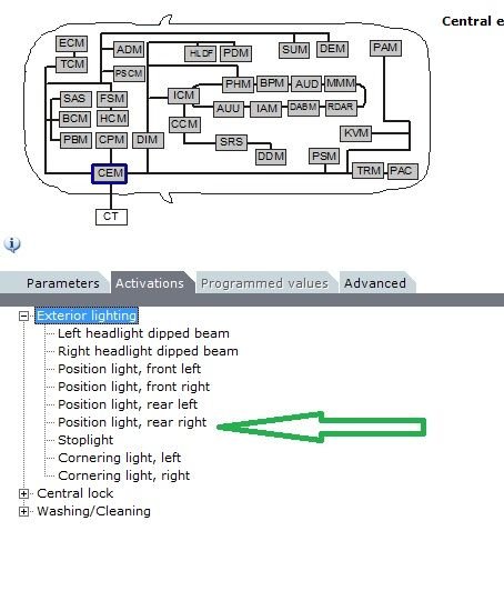

I would first scan all the control units with a compatible scanner - looking for codes/lighting abnormalities in the CEM. You can also turn those lights on individually with a good scanner. Water intrusion into the CEM seems to be a common theme - that can do all sorts of crazy stuff, but usually more symptoms than just a parking light that's too dim or bright.
If nothing abnormal unfortunately you may have a tail lamp going bad. The LEDs are not shown as being sold by themselves. To prove it and make sure it's not the wrong signal being sent to one side - if the connectors are the same on both lamps - I would take both tail lamps out and plug them into the opposite side and see if the dim/bright follows the lamp. .
