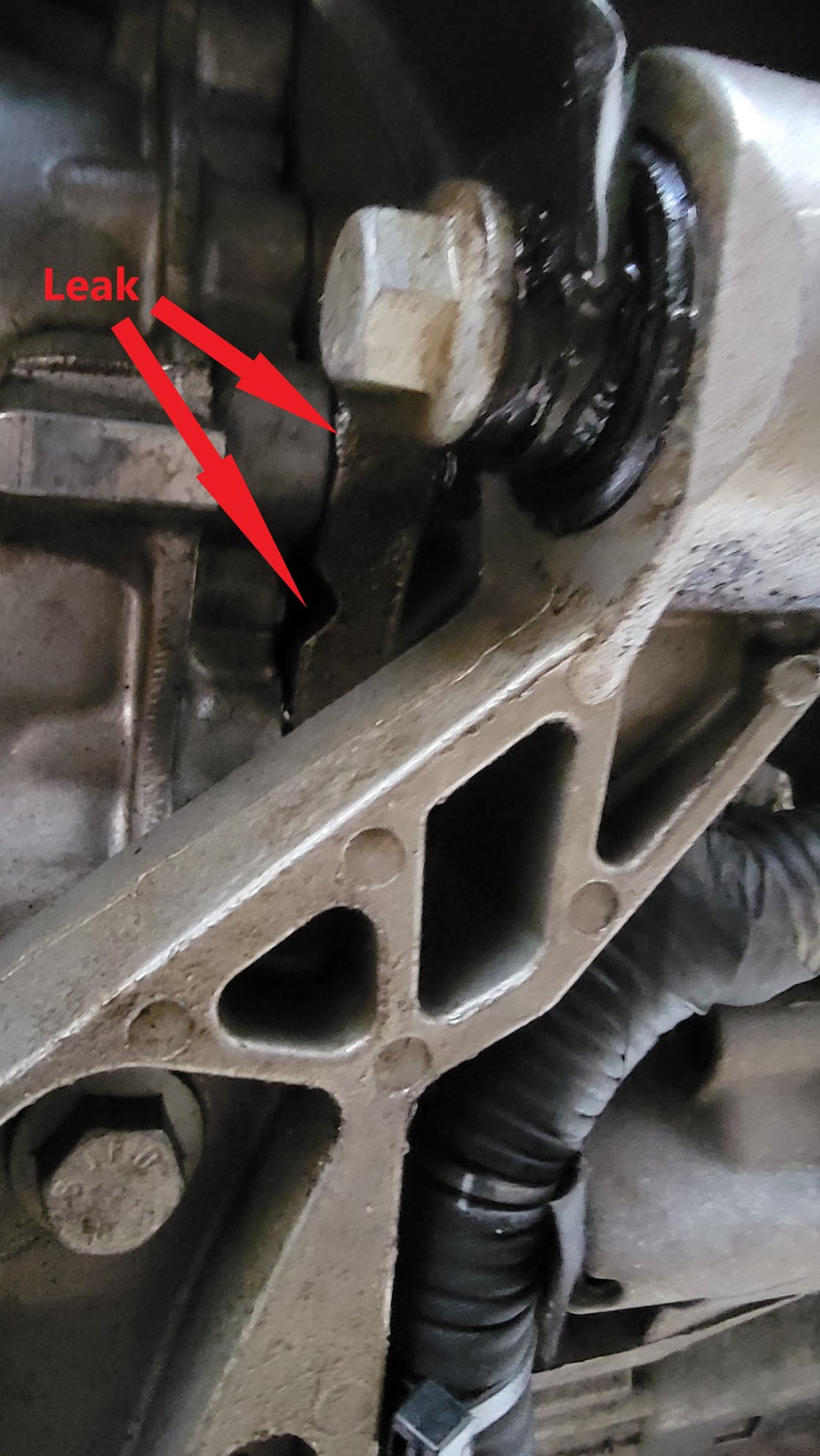

2011 Volvo S80 T6 AWD is leaving marks on the driveway. Just trying to confirm my fears that there is a transmission seal that is leaking. It looks to be coming from between the front diff and the trans case. I'm good with wrenches (long time Land Rover owner) but any pointers on this issue? Better to sell and find something else or is this even doable? The car has 182k miles and drives great.
It definitely isn't power steering (electric) and not engine oil (smell).
I see the drain plug but I don't see where the fill is (top side?). Opinions?
Farther away
A little closer
Up close and personal

It turned out to be the transfer case output shaft seal (part 8653927). On the 2011 T6 AWD, it was a pretty easy fix even with only jackstands. The hardest part was getting to the bolts on the passenger half-shaft pillow block bearing. It's been a while but I don't think I actually removed the axle shaft but I could be mistaken. The transfer case only weighs about 30 lbs. and the bolts are easy to get to (looking at you Land Rover LR3 transmission-transfer case). When I was there, I actually replaced any seal I could easily get to. When you put the seal back in the transmission, there isn't an actual backstop as you could push it all the way into the transmission and then really be in a world of hurt. Check where it is before removing and then set it back in the same distance and square in the hole.
I think these are the steps I used:
* jack and block
* open fill plug on top of transmission (absolutely the first thing...can't the fill plug out, do not proceed!)
* drain transmission, not transfer case. The drain plug is not just a plug but it has a small screw in the middle that you remove (for filling procedure) and then use a large hex to take out the actual plug and pipe on the back.
* remove starter and transmission brace (the link in the pics between the 'leak' and the 'crossmember'
* take out passenger side drive shaft (cv shaft, half shaft, call it whatever you want). I don't remember if you have to remove it from the car or if I unbolts along the shaft so you don't have to remove the wheel, hub, and strut.
* drop the transfer case
* replace seals, etc.
* reverse
Filling the transmission is a bit of a procedure but Google and search are your friend. Nothing crazy just a bit of a goat rope with the temperature, small screw in the middle of the drain plug, etc.
https://www.volvopartswebstore.com/c...rbo-parts.html - This is a what I used for getting out the "Adapter gearbox, angle gear and overdrive, and bevel gear"
Overall, took 3 hours or so...highly dependent on your wrenching abilities. No crazy tools necessary, just 10, 12, 13, 15, and a larger hex. I don't have the car here (kid at college) or I'd actually get the hex size for you.
Good luck. Nothing crazy, just bolts. And they are easy to get to!!!

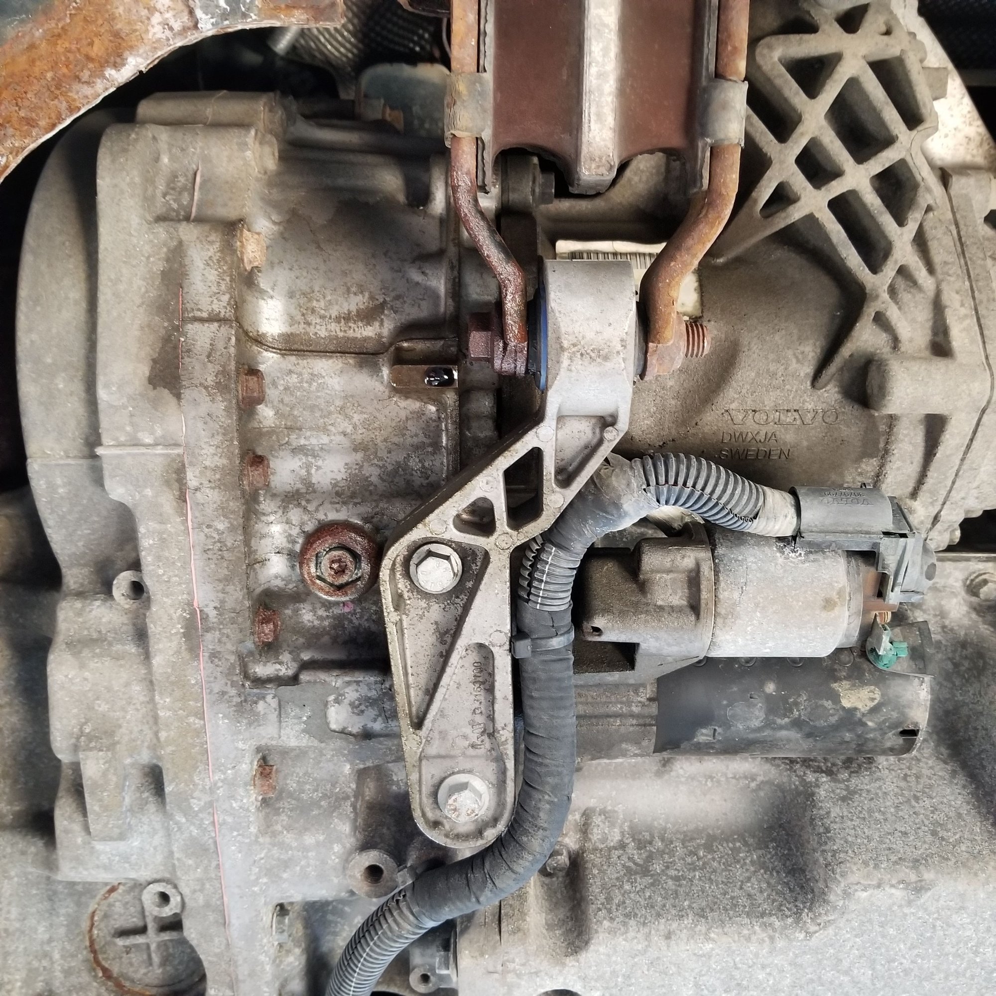

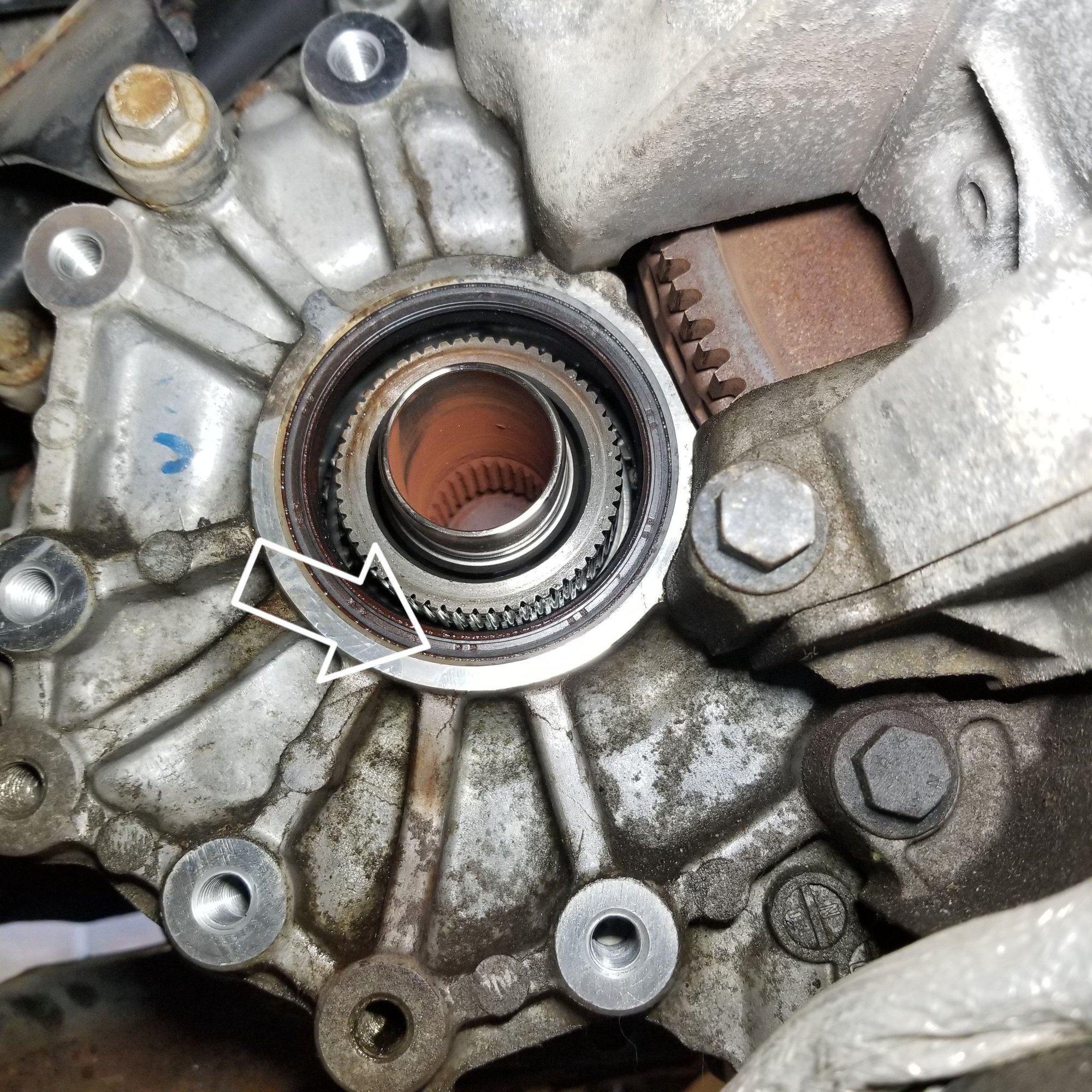

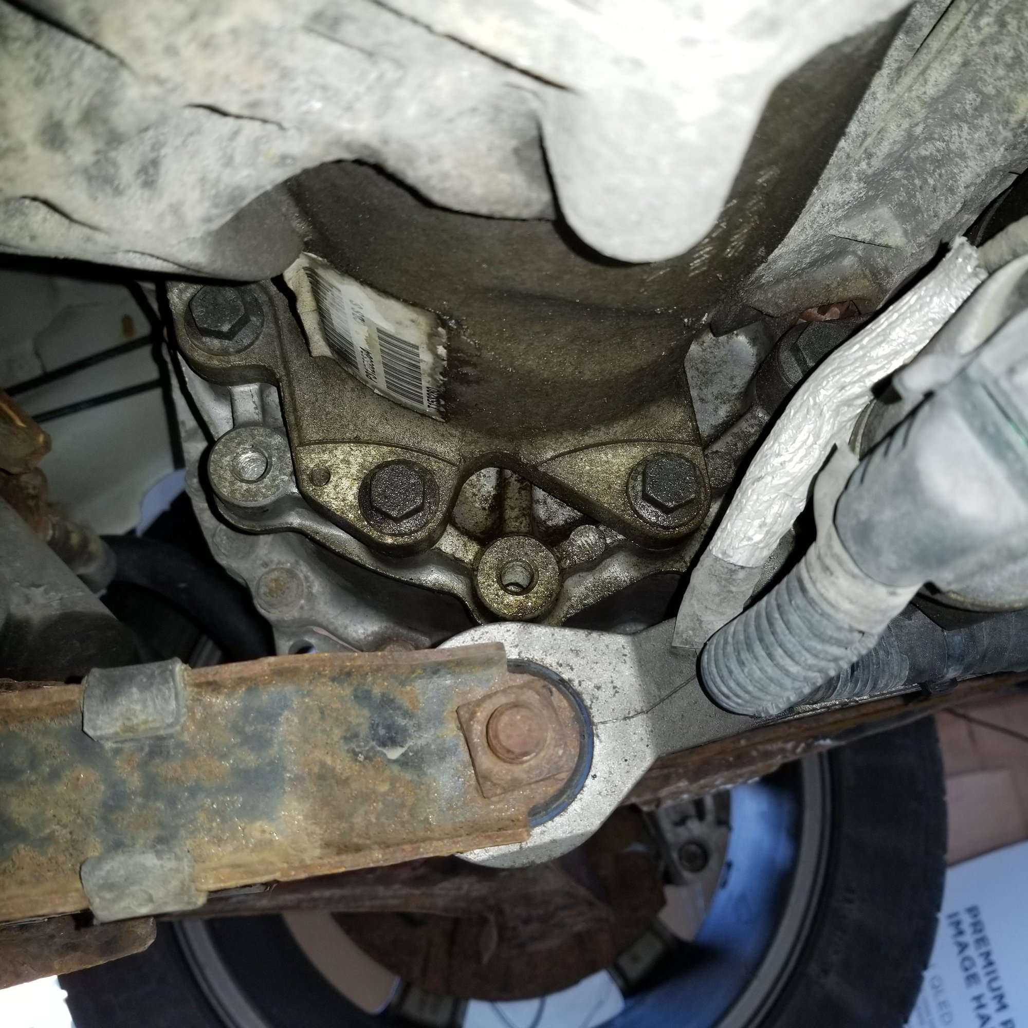

If it can help someone with similar oil leak issue, I had a leak on the 3.0L T6 engine (2012 XC70). In my case it was the outer seal on transmission output.
Leak. Under transmission.
Leak. Under transmission (close up)
Transmission with transfer case.
Transmission with transfer case (close up)
Transmission outer seal causing the leak.
