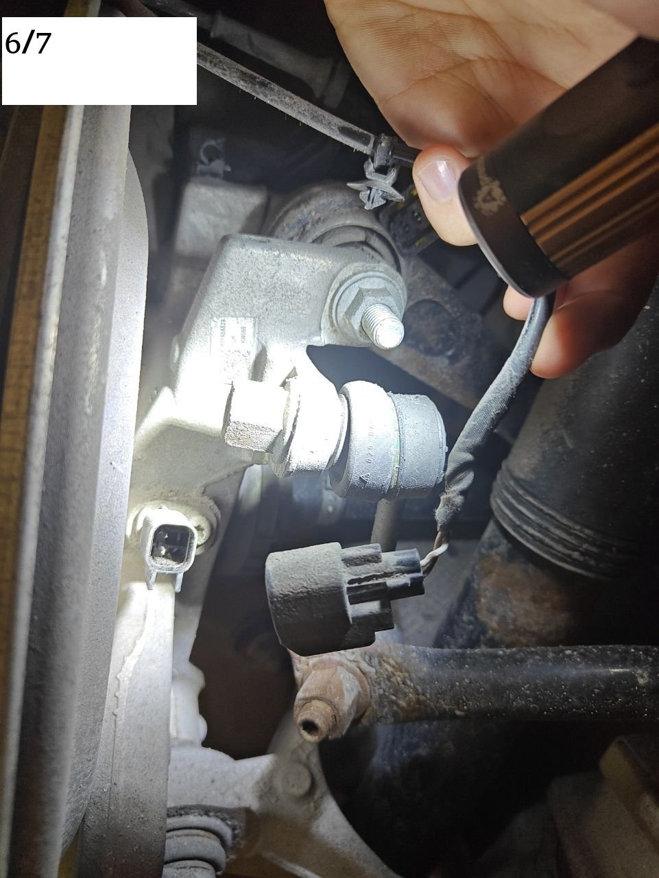

This was helpful, but I have an S90 and the left side was being troublesome, not the right like in the video. In the absence of any useful diagrams I started digging on the car itself, trying to trace the harness back to the nearest plug so I could test the wires to make sure that was the problem and then work from there. It turns out the break in the wire was literally right by the plug at the end as I discovered on day 2 but nonetheless I did learn something here that may be useful for others.

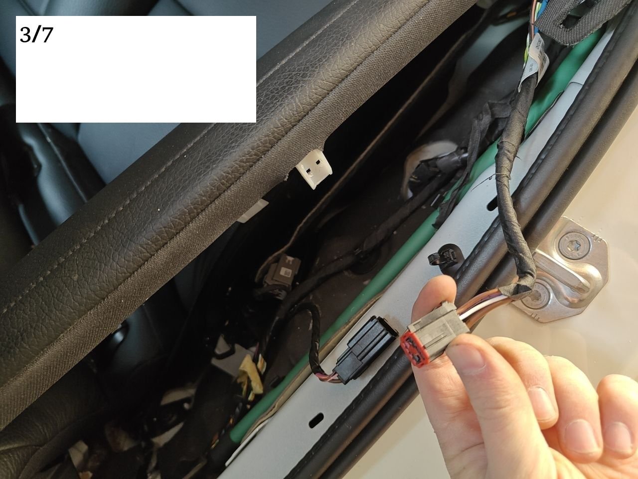

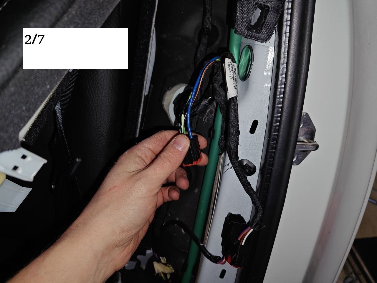

In the process of tracing the harness, I discovered that it goes under the car and over a piece of the subframe. At that point, hidden from view, it joins up with the harness coming from the Haldex controller, which is visible in the middle of the underside of the car. These two meet, then turn left and come back up the side of the car behind the shroud in the left rear wheel well, as per image 4/7. You will be able to see in the image where they pass through a grommet and into the interior of the car. In images 2/7 and 3/7 you will be able to see that the grommet requires you to detach the rear seat cushion (easy, google it), fold the seat down, and then use a flathead screwdriver to remove the leather panel and plastic panel in near the door. There's no proper instruction on this but it's not rocket science. Upon doing so you will note that the obvious plug has the wrong wire colours, as it is the Haldex one. The brake one passes in closer to the door, which I didn't realize at first as I hadn't pulled off the plastic cover.

After having ripped everything apart, I used a chunk of wire jammed in the plug and a cheap multimeter to first check that the circuit was indeed broken, then to confirm which wire was broken. In my case it was the brown one, as the purple had a resistance measurement.

2/7 plug inside car beside left rear seat

6/7 close up of the ABS sensor plug from the back
