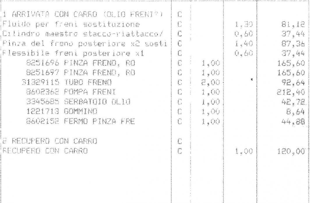

Here´s an attachment of the list that the mechanics told me they ordered:
and heres what I´ve managed to translate:
51040: brake fluid replacement
52130: master cylinder ex-piecing
51208: replace rear brake caliper
52205: Rear brake hose
8251696: Brake caliper Rear axle left http://www.skandix.de/en/spare-parts...-left/1004962/
8251697: Brake caliper Rear axle right http://www.skandix.de/en/spare-parts...right/1004963/
31329115: brake hose
8602362: Master brake cylinder http://www.skandix.de/en/spare-parts...inder/1014170/
3345685: Oil tank
1221713: Rubber sleeve for brake fluid reservoir
8602152: Carrier, brake caliper http://seekpart24.com/trw/carrier-brake-caliper-bda410

I can't see more than 1 caliper and 1 hose and fluid necessary to repair that if it's only one side. Have them point it out to you.
Ed

thats kind of what i was thinking, but im not very good with car-repairs...
It feels like they are trying to make an extra buck by ordering all new parts for half the brake system.
Thanks for your advice!

If the car is on a lift, the damage should be obvious to anyone. They should only repair what is damaged. The pricing could kill you. There's no need to replace the master cylinder or the other caliper when only a hose is broken.
Ed
