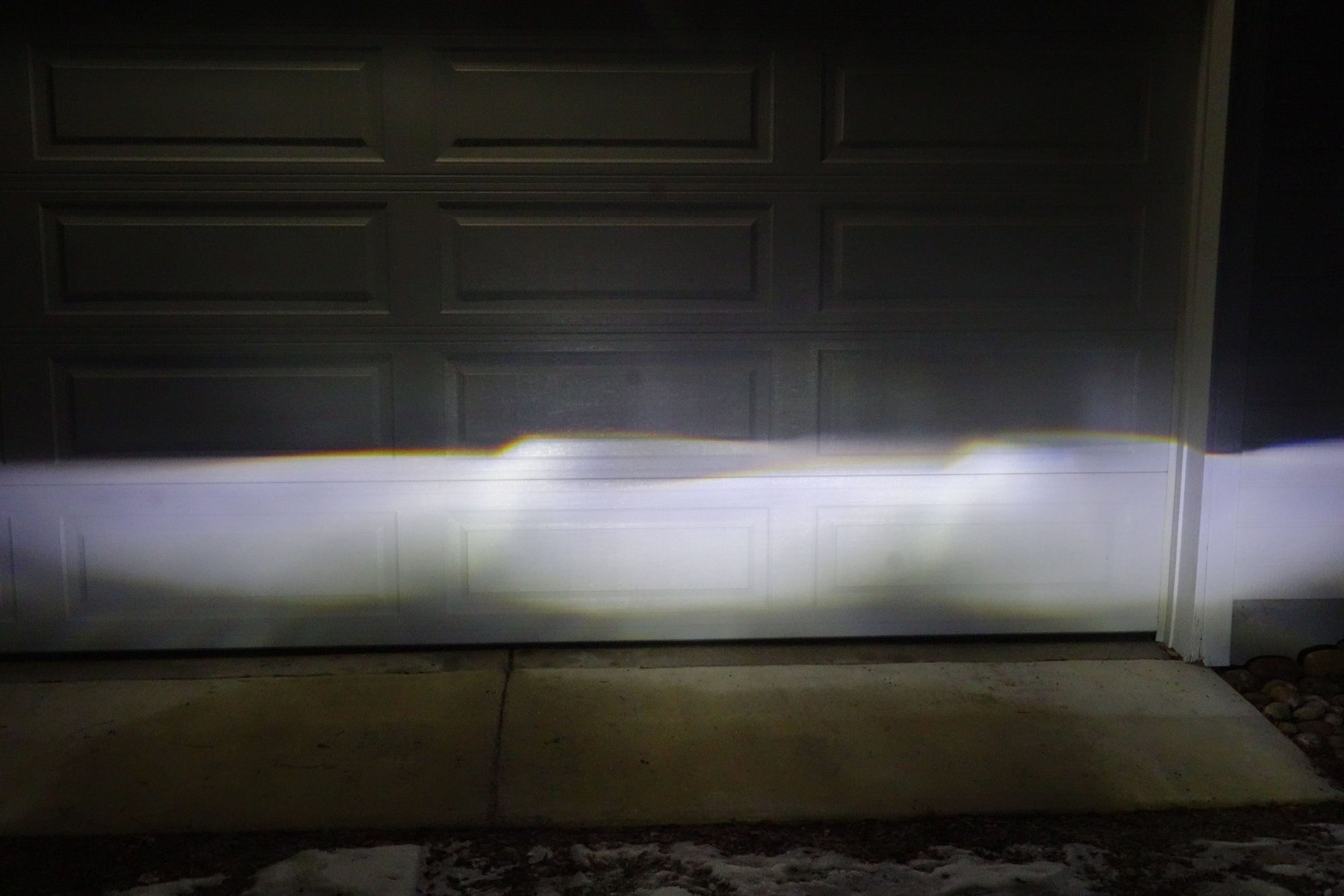

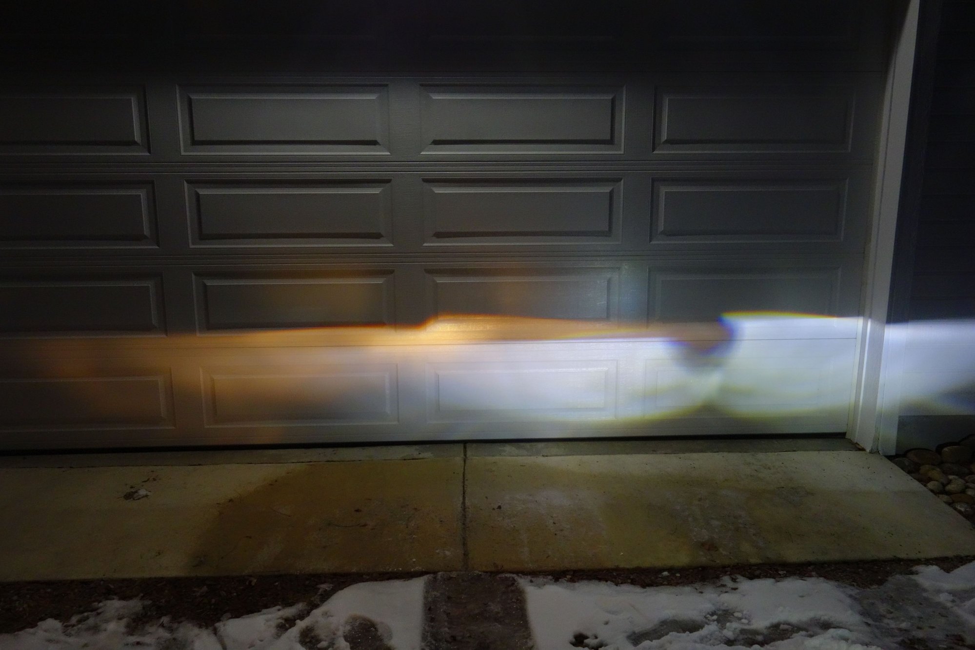

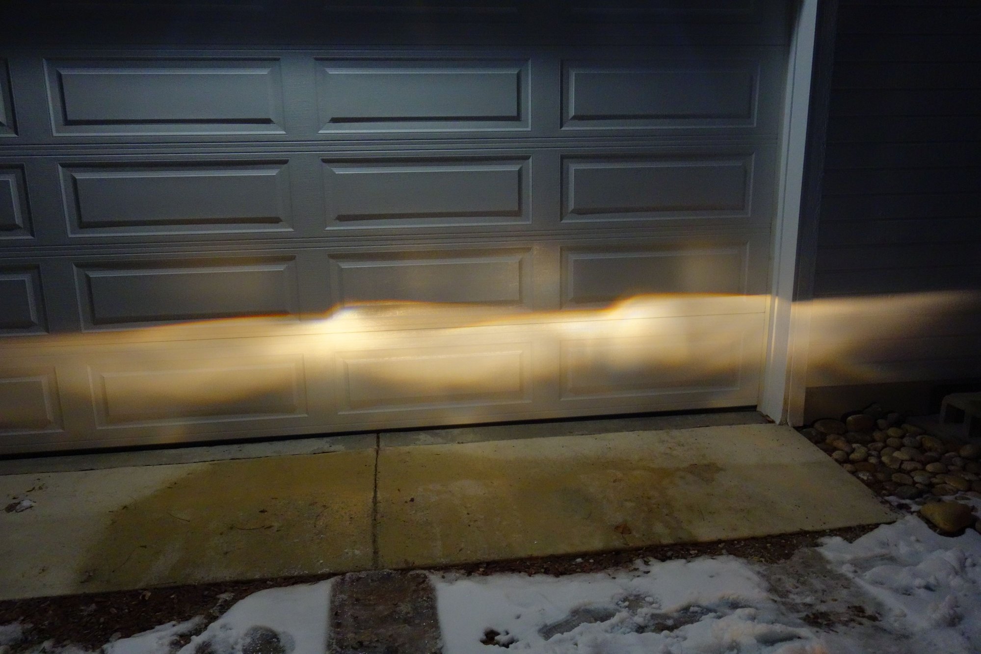

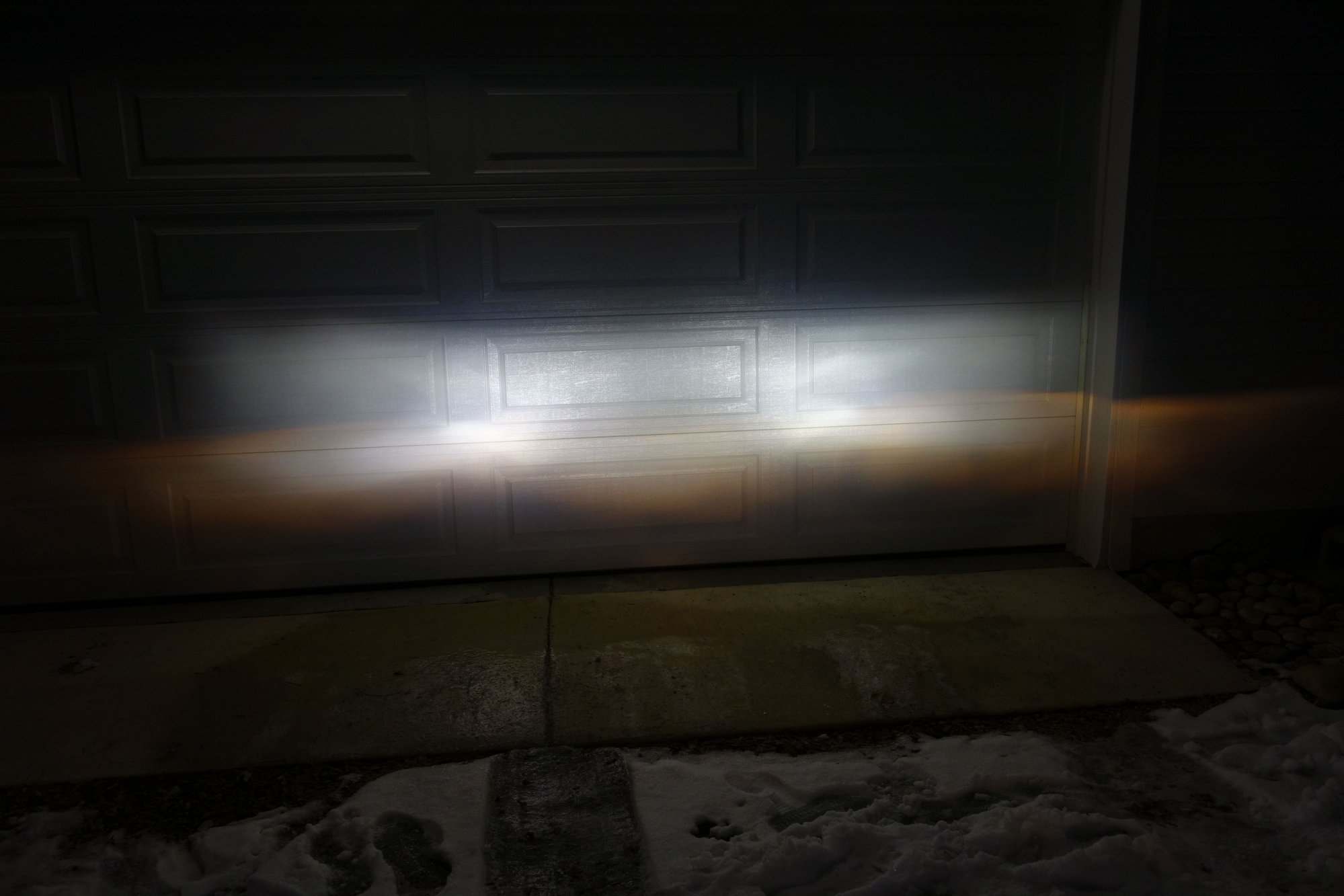

I installed the LED low-beam "bulbs". These lights DO set a BOW. The light was very white & bright but had a center dark spot. I also adjusted the lamps a bit higher. Out on the road a few vehicles passed in opposite direction seemingly not bothered by these lights I was less than impressed but admit they are brighter than the halogens. If it were not for the center dark spots I would be good to go with them, I think.

Halogen low beams

Halogen low beams combined with LED high beams

When I installed the low beam LEDs I twisted the bulb around to various positions but that did not affect the pattern. It did not appear to matter which direction the LED was pointed. As you can see from the LED pattern on the garage door, the LED light is significantly brighter than the halogen and has a well-defined pattern except for the dark circle at the center. I think the shape of the end of the LED causes the dark circle. Her is a link to the LEDs I used;

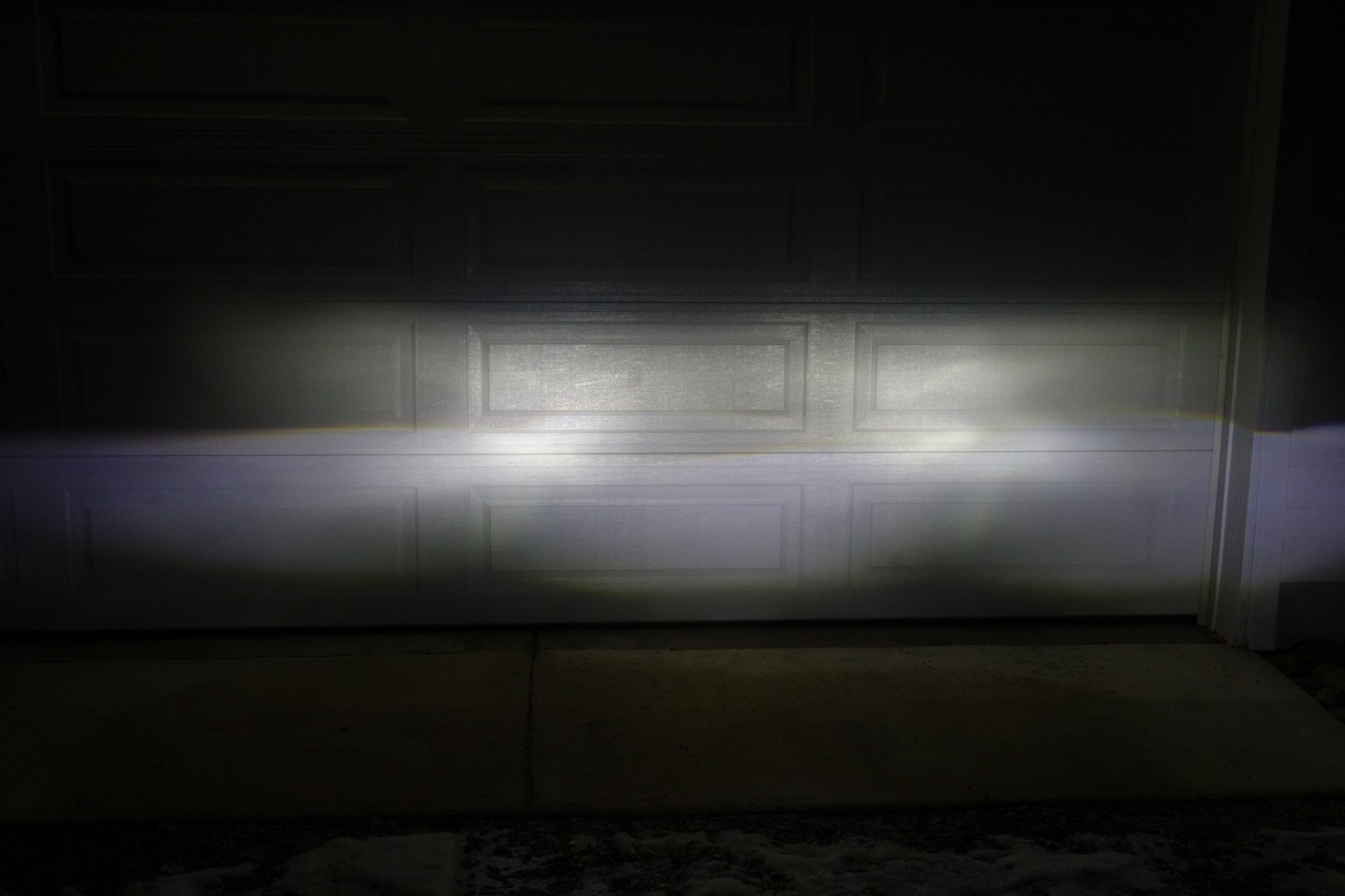

As I stated before, the first set of low-beam LED bulbs did not matter how I twisted and turned them in the socket, the pattern remained the same regardless of the direction the LEDs pointed. My disappointment was with the dark circle in the center and the warning message, otherwise they were nice and bright. I just received the second set of LED bulbs and installed them. They have a nice bright well controlled pattern with no dark center spot, and better yet, no bulb failure message.
Second set LED low beams
Second set with high beams on

Okay, I understand what you are saying. I did not compare that aspect of the bulbs, but, all-in-all, I like this second set. They really light up the road and do not interfere with oncoming traffic. I believe the difference is the shape at the end of the bulb. The second set being smooth and flat as opposed to flaring out at the end.
