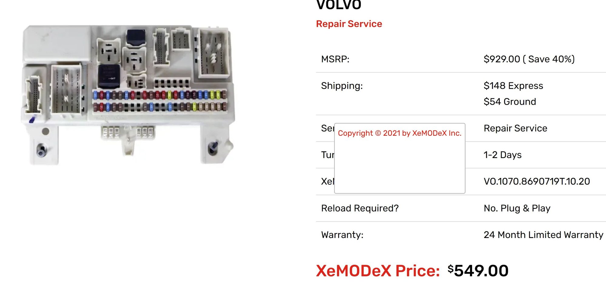

You might have a problem with water damage in your CEM. That will cause all sorts of crazy symptoms.
A company such as xemodex can solve that if cleaning the found corrosion does not.
