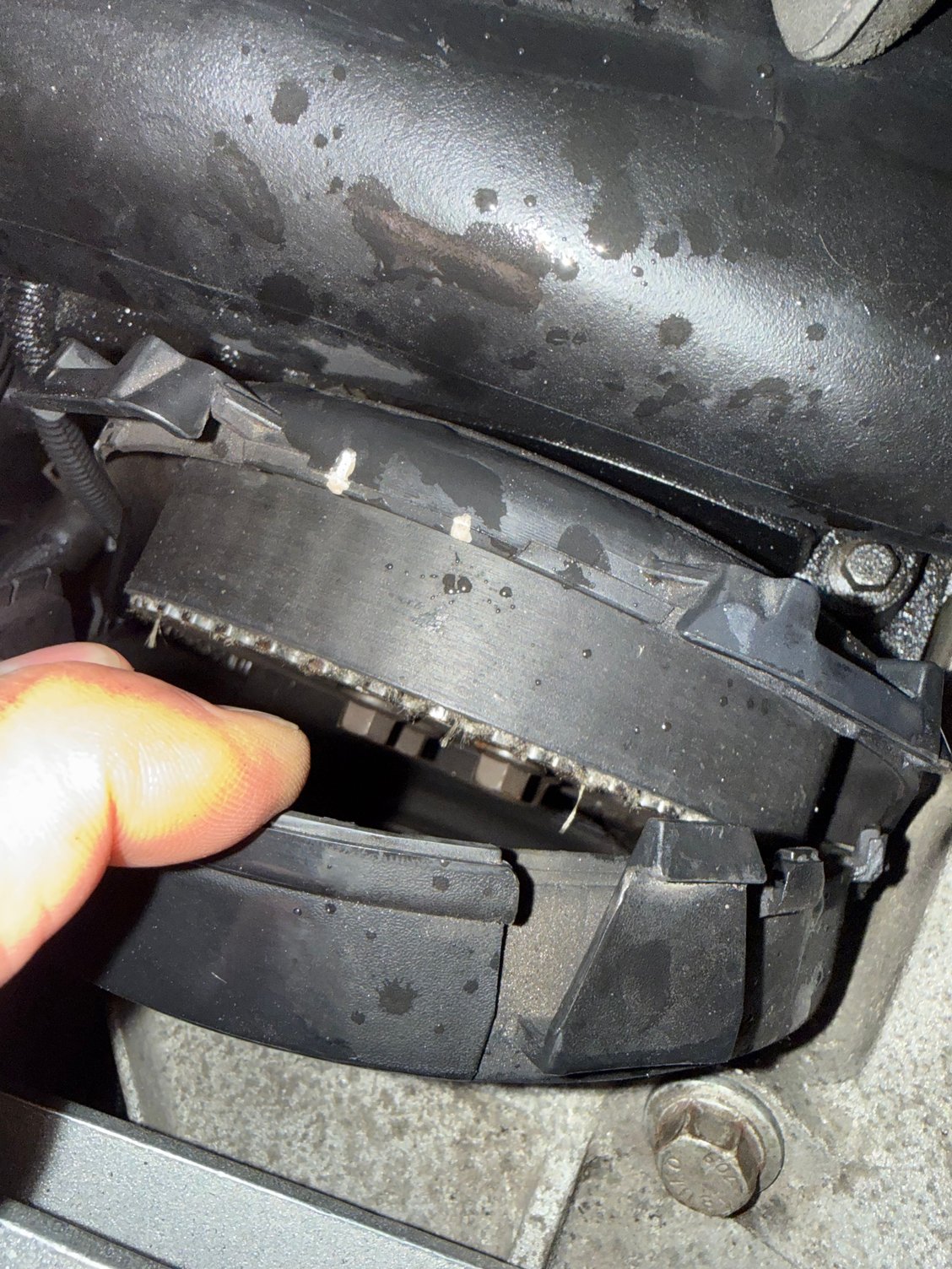

Default 163bhp D5 timing belt teeth gone
So the aux belt has snapped after a noisy ps pump pulley and it took out the timing belt as the teeth are missing but still intact. This
happened at low rpm’s in town
I’m presuming there’s internal damage and no chance of it coming off all rosey with just replacing the timing and aux belt with a new ps pump and all is good ?
anyone came out lucky with a belt snapping on an older 2008 v70 D5 with the white engine cover ?
