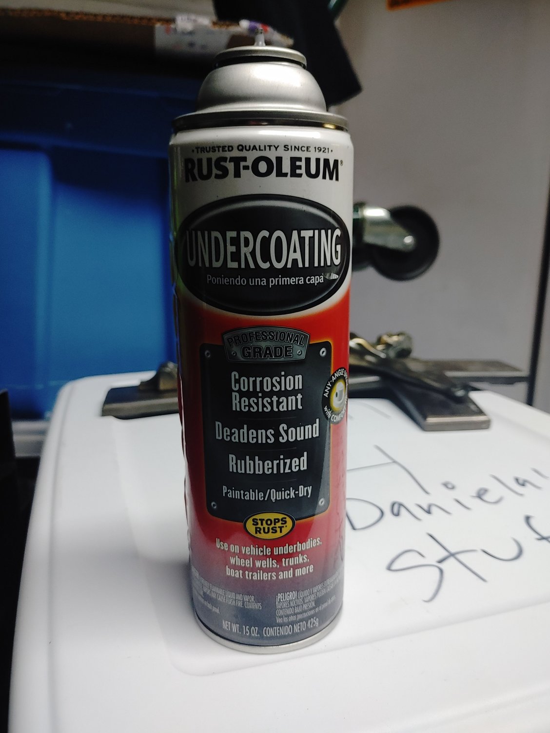

Hey good people. I might have a potential sticky here on the infamous dash mounts that crack and make all that crazy noise. I have some pictures of the product used to fix it. Fairly simple fix.
1. Take of windsheild cowl and wipers, and fuse box cover
2. Take out the bolts that hold the dash up. 10mm
3. Spray rubberized undercoating into the holes(spray the hell out of them all). Use a red straw attachment to fill the holes.
4. Do the same for the bolt behing the wiper transmission
5. Drill a hole between each bolt holes. Regular length drill bit and not a big hole either.
5 bucks at your local big box store
Add the red straw to get all the way inside the firewall.
It will smell for a day or two so leave your windows cracked for a couple days to assist with the odor.
This will eliminate most of the cracking dash pads noise.
