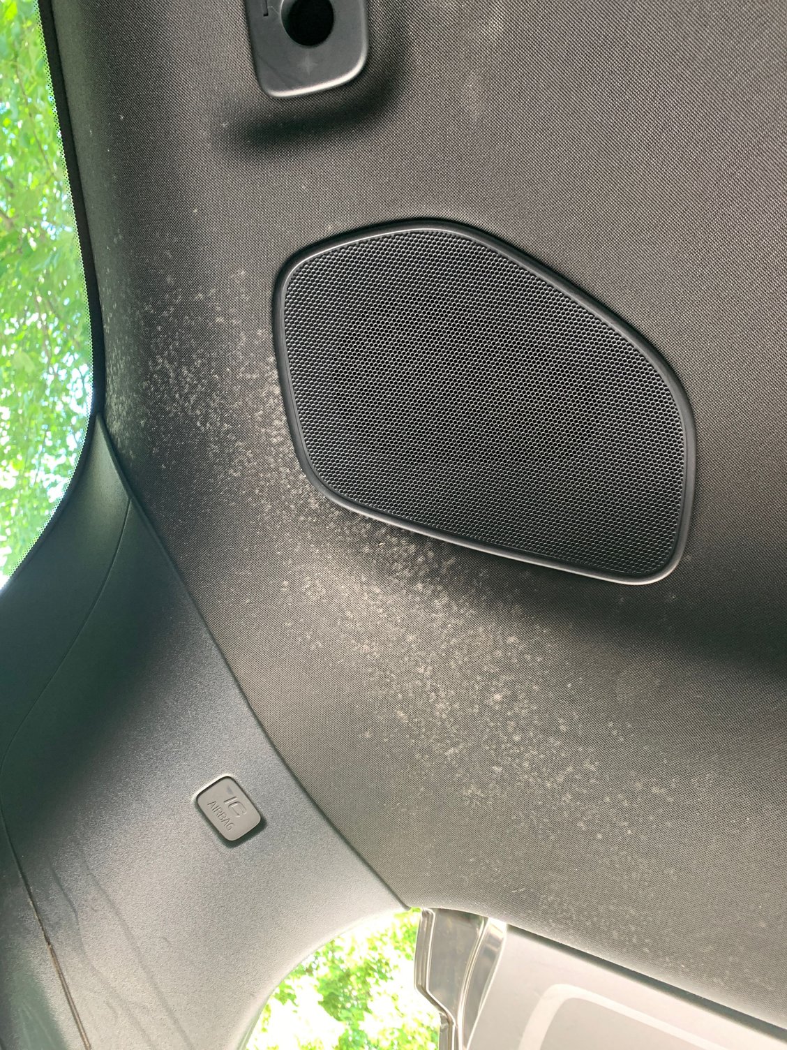

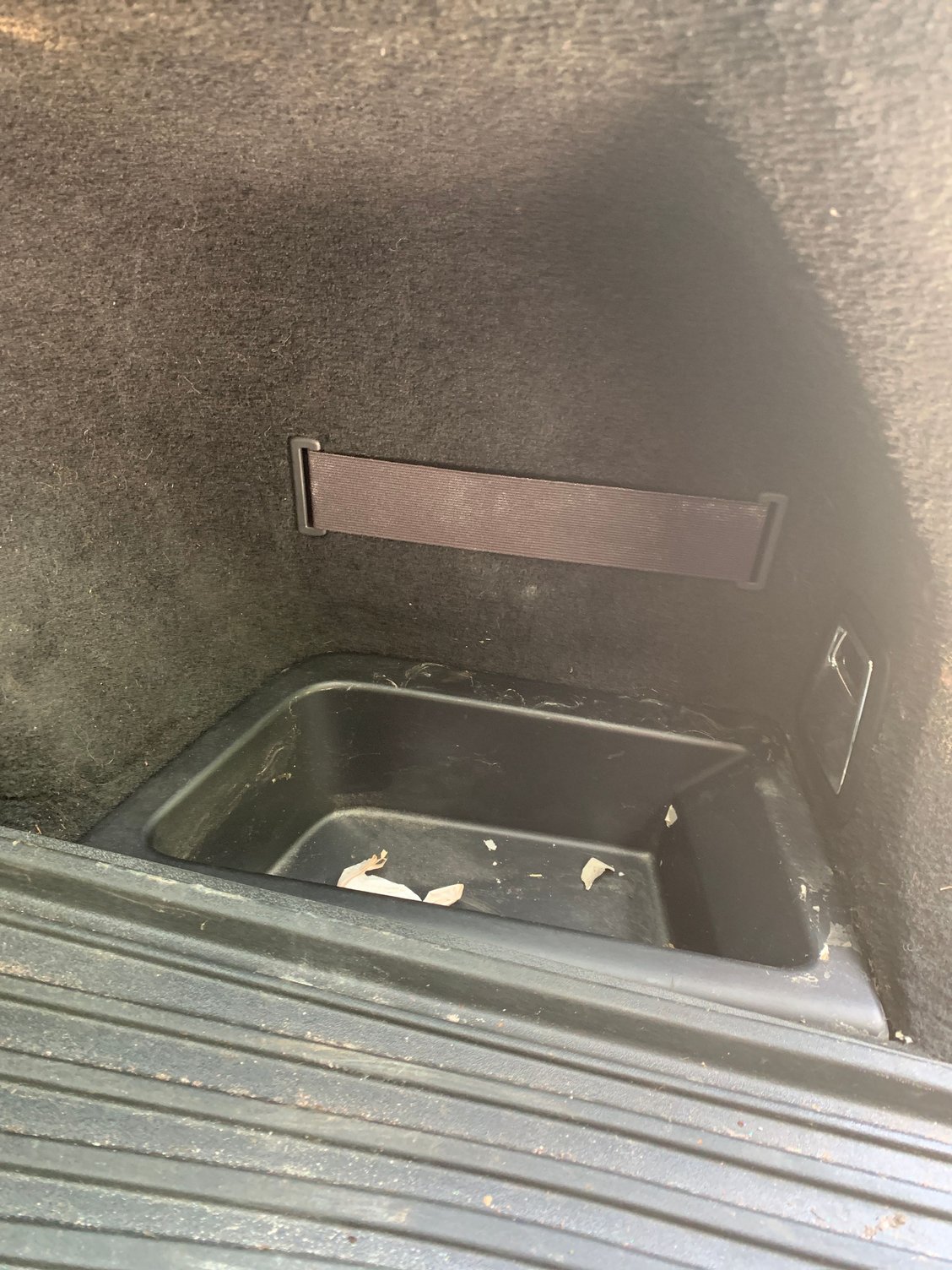

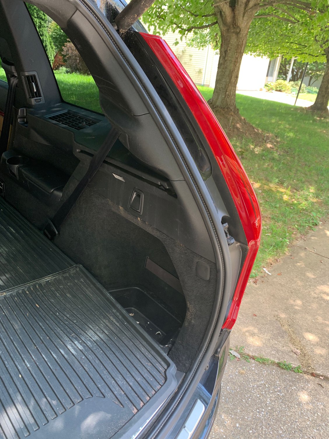

Default 2016 XC90 Leaking onto headliner in back of SUV
Bill
our XC90 is leaking onto the headliner in the back of our suv. We end up with a puddle of water in the small well in the back of the xc90. I have attached pics. Any reason water would be getting into the headliner and then leaking into the car. Thanks for your help.
