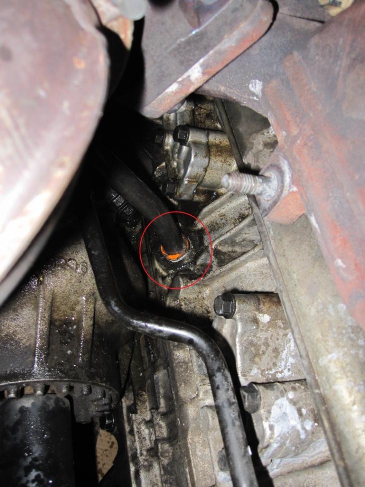

I dont know what is wrong with this car.
I finally got it all back together, I was very proud of myself, pulled the head and replaced it and the car started almost immediately.
I should have known it was too good to be true.
So I went around the block just to hear it run, it stalls as I literally get halfway around the block, no shutters, no rough idle, it just slowly revs down and the battery, CEL, and Transmission arrow illuminate. It started up right away with no trouble, then 20ft later same thing revs drop to 0 and the CEL comes on.
I had to do this a few times to get back to the house. and as I drive through the alley I see a trail of "liquid" coming from where the car was sitting.
I open the hood and there is smoke galore coming from the rear of the engine. and I thought it was coolant leaking from a hose but after closer examination I find that it is oil!
Coming from a pipe. I took a picture of the pipe that is leaking...I have no idea what it is and what it is for.
I started the car again and watched the pipe and liquid is spewing from the as if its under pressure.
HELP!
I got pictures for reference.
Attached Thumbnails Oil gushing out back of motor! Can you help tech?-img_1178.jpg   Oil gushing out back of motor! Can you help tech?-img_1192.jpg

I forgot to mention that when I opened the hood I noticed that I didnt tighten the clamps to the intercooler piping and the hose popped off, so I was hoping thats why it was stalling on me.
I took a picture of the leak just to show you how bad it was.
The previous photo of the dipstick shows the oil level which is "empty" and the gunk that is on the end of the stick. I don't know why its like that.

The one pipe with the orange?
If so then that is the turbo oil return line to the block. You can get a new gasket and seal cheap. I would start with that and see if the leak stops. It will usually not leak at just idle but only under boost.

So, I just finished the oil return pipe, started it and everything was fine for about 5 minutes then it started to smoke and the car stalled while it was idling.

I would watch and try to see where it is coming from. Maybe the oil feed line cracked.

probably the oil fittings on the turbo.
could have left crush washers off the banjo bolts as well.
pretty sure they are banjo's... but yea check that stuff!

Ok, we're good!
I got the oil leak taken care of. It was the gasket set wrong when I put it on and was still leaking.
I also replaced the MAF sensor and she stopped stalling on me.
