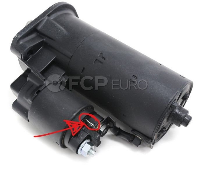

Are you sure its fried and you didn't accidentally unplug/knock a terminal from the starter during your shocking experience? There is a spade terminal that can be temper-mental and if that is loose you will get absolutely nothing when trying to start the car. Ive done something similar with a flathead (insulated handle thankfully) and I am surprised the solenoid would be fried.

Said terminal

mmm thanks i will check that

wiggled the wire,,,fixed! thank you! i'll try to get it off and clean it up later
