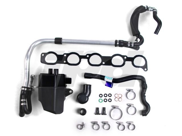

Due to the part ordering, weather and holidays did not start work yet. I've the parts, PCV Breather system kit, as displayed in the attached photo.
The part you mention not seen in my photo so is it an additional item to replace ?
https://www.fcpeuro.com/products/vol...volvo-30731007
Hopefully I'll find some detailed videos to help carry out this repair task If I do, I'll post them here.
Thanks
pcv breather system kit
