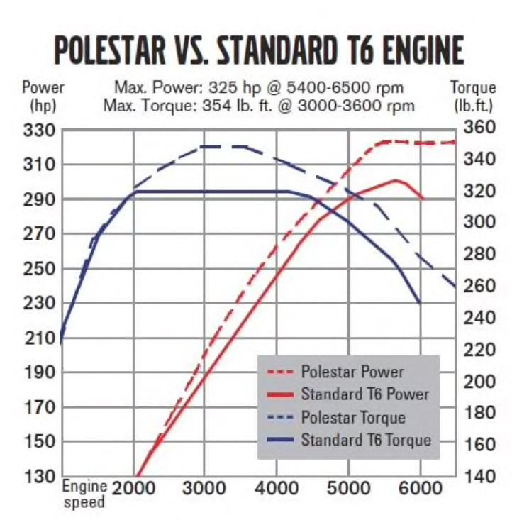

You are correct, the T6 is overall a better all around option. However, you can have the best of both worlds by adding the Polstar option to the T6. I bet you will out perform the T8.
