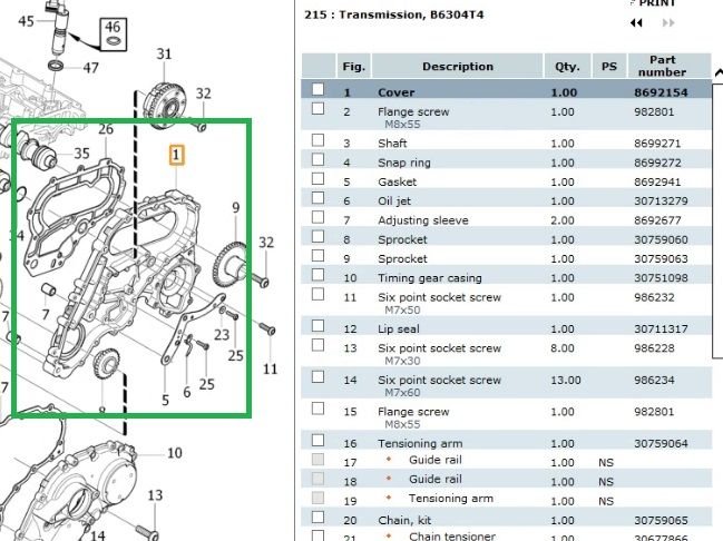

I trust you have the t-6 engine - The pipes in the green square are behind the engine - not easy to get to because the exhaust is on top of them. I would pressure test the system and figure out exactly where it is leaking - then develop a plan to solve it. Whether that is a DIY or a professional fixing it. Those pipes are not an area where I've seen any leaks - (other than the water pump itself can leak and spray all over the place back there)

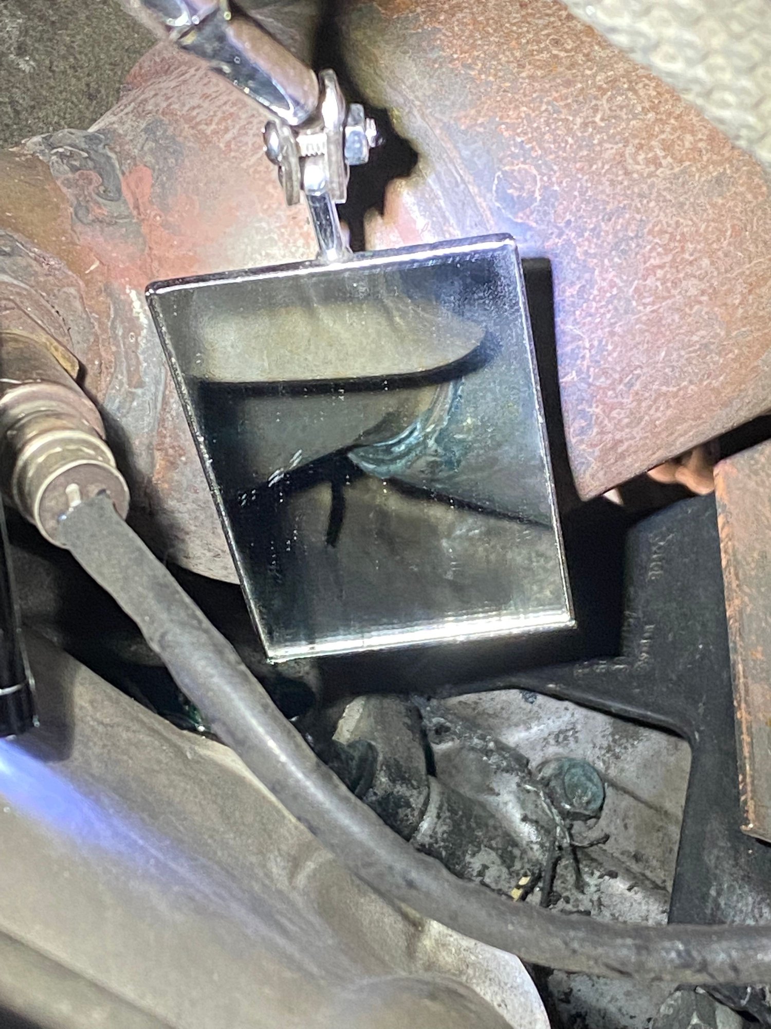

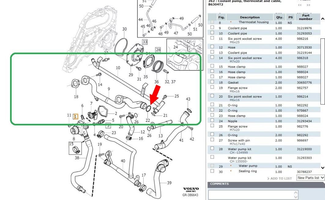

Yes, it's the T6 - I should have noted that. A pressure test isn't necessary. I know where the leak is coming from. I just can't figure out to get access to it. Based on what I can see with a mirror and snake cam, it looks like my leak is coming from the O-ring that's #22 in the parts diagram. I did the best I could to get some photos, but it's in a very inaccessible spot. Is there any way to replace that O-ring with the engine in the car??
Leak looks like it's coming from this O-ring.
Taken from above with a mirror. Coolant is visibly dripping.

Might be easier taking the water pump housing off to get to it - (which is still a very large job requiring many special tool to align the cams) - rather than the pipe off the engine. It's unusual for those orings to leak - so am wondering what caused it. Either way as you can see it's going to be very difficult to get to.
