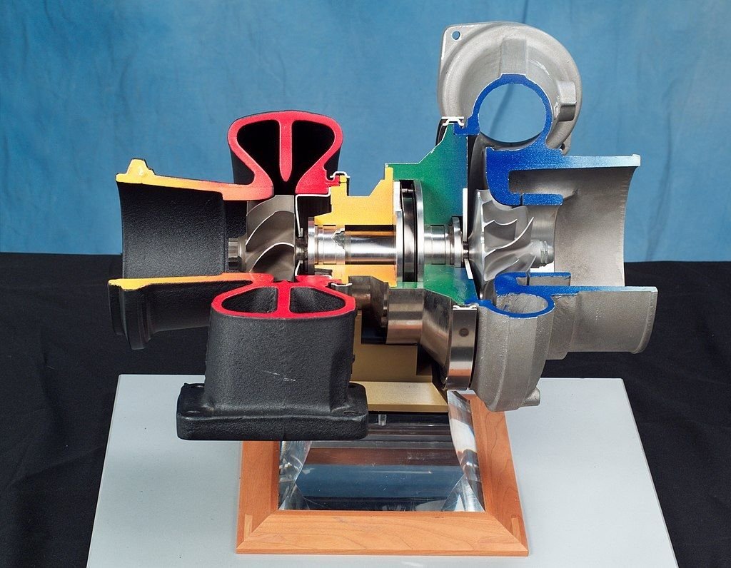

If you hear a whine from a turbo the clearances are not perfect. Really noisy is the sound of the turbine wheels touching a housing. If you hear air sucking when accelerating or blowing off when decelerating - that has has to do with noise insulation. - What sound are you missing?

My 2001xc70, 2001v70t5, 2002xc70, 2004 xc90t6 (twin turbo), 2015xc70 t6, 1981 240t, 1986 Maserati Buturbo, 1986 Porshe 944t - all had almost silent turbos. Well the Maserati turbos had to be rebuilt twice - that car was a mistake>
If the turbo is "broken" as in seized or shaft snapped (saw a A4s audi like that once) - the car will be VERY sluggish - like having a blockage in the exhaust system. At that point they usually dump oil into the exhaust also. And if bushings are worn the fan can eventually touch the housing - and be very noisy.
Quiet is good - means the clearances are perfect and the bushings are not worn. A turbo is simply 2 fan blades connected together with very little clearance between the housings and the blades to compress the air.. Try to time 0-60 if you think your car is sluggish.
